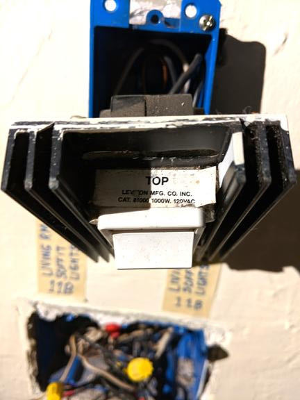

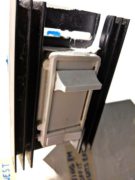

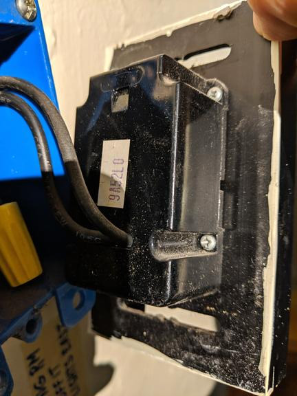

I have a dimmer switch for a light fixture, the switch is a Leviton 81000-w switch. It's rated for 1000W.
It has a raised profile which initially I thought it's a surface mounted box or an existing box with an extender. But it's the actual switch that has a raised profile about 3/4". It is a piece of metal with fins, then over it a screwless plastic plate.
Anyone know what these fins are for? Is it some sort of decorative feature (can't be if it's cover by a plastic cover plate right?) or does it serve a functional purpose? It's not a heat sink is it?
1 - 7 of 7 Posts
Those are part of the heat sink to prevent the dimmer from failing from overheating if used at its full rating. They still work when the plate is installed since the top and bottom are still open and function to provide a chimney effect.
They dissipate heat when used to full potential.
The fins can be removed however that changes the unit an 800 watt rating.
From the Leviton spec sheet.
Cat. No. 81000: The dimmer must be derated to 800W when both sets of fins are removed. If no fins are removed, derating is not necessary.
