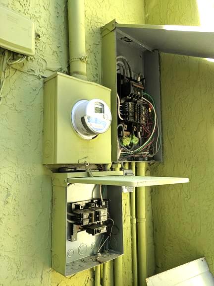

I just moved into an older house that was built in 1941 and have gone through multiple renovations over the years. It has three separate panels.
The meter is on the outside wall of the garage, and next to the meter are two panels which I labeled "A" and "B".
Panel A - has the main breakers to turn off EVERYTHING in the house. It is labeled "MAIN 1 OF 2" with a Sharpie. It controls the wiring in the two original bedrooms and bathrooms, as well as the downstairs central AC handler and compressor.
Panel B - controls the outside wiring, the pool pump, spa heater, pool lights, outside motion lights, pond pump, post lights, front gate motor.

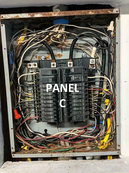

Then inside the garage I have another panel, which I have labeled "C".
Panel C - controls the kitchen, garage, living room, dining room, second floor addition.
I am thinking panel A is the first and original panel? Then panel B was added and then the panel C inside? So panel A is the "main" panel and B & C are subpanels?
As I try to determine which breaker controls what, I need to label each of them so I know what breaker controls a particular receptacle or switch...I make a notation on the back side of the cover plate that this is circuit 8A, this is circuits 5B/7A etc, but with three panels I need to reference which panel. Is there a customary convention to follow for labeling the panel+circuit? Is it something like A,B,C or I,II,III or something else?

So is there a "proper", conventional, customary way to label these three panels?
Panel A has "MAIN 1 OF 2" written on it, Panel B has "MAIN 2 OF 2" written on it but is a sub panel of A. Panel C has no label.
I called them A, B, C on here just for easy reference. Are they typically labeled a certain way I II III or what?
I would like an easy but short reference. For example, the 240V window unit in a den is on circuits 5B/7A on the panel inside the garage. I would like to be able to label it [PANEL: Circuit Number] something like that but not sure if there is a standard way to do it.

For residential, not really. There is a standard for commercial work, but that's for large installs with dozens of sub-panels. It's unnecessarily complicated for resi work. I'd probably just put stickers that say "A", "B", and "C" on the three panels, and then number the circuits by breaker slot number in the panel. So, for instance, breaker 17 in panel C would be circuit C17.

Ok got it. But would calling panels ABC adds to the confusion? Is it better to call them I, II, III?
I am thinking when someone sees "C12" could they be thinking the C just mean "Circuit"? Or B4 means "Breaker 4"? Plus I have tandem breakers so I may have B6A and A14B?

As long as you are consistent, and you indicate what rules you are are following, then you can do whatever you want.
For example:
P1:B3:C4 could stand for Panel 1, Breaker 3 Circuit 4
or
P1:L:B3 Panel 1, Left side Breaker 3
Since you have multiple panels, with probably different panel manufacturers, you may want to consider adding some additional items to your breaker list. For example, breaker size and maker.
Panel 1
Cutler Hammer
Main Panel
200 Amp Main Breaker
Uses BR type breakers
Panel 2
General Electric
Sub Panel
60 Amp
Uses THQL breakers
Panel 3
Siemens
Sub Panel
100 Amp
P1:L:B4:20amp
Or something like that.
