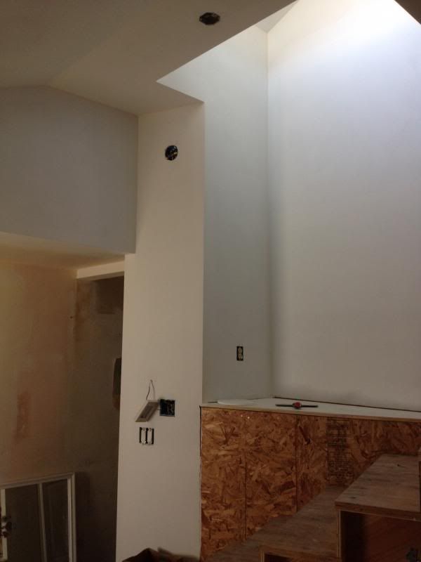

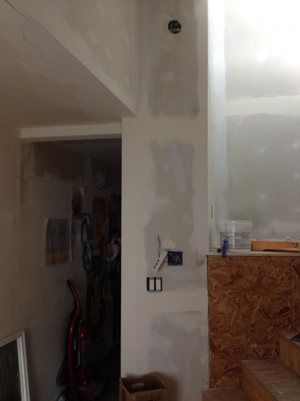

Having just finished the drywall in my addition............
Skim Coat.
Knock down is done because drywallers and hang wall one day...tape and mud the joints the same day....sand and shoot the knock down the next day and call it done. Basically, it hides crappy work.
If you ever have to go patch a wall that was done knock down....you will always have that patch showing. Almost impossible to match.
Smooth finish? Easy to patch.
For your skim coat...take your mud and add a little extra water. Just a tad to make it a little thinner. It actually goes quick. Then a quick lite sand.
After you primer and paint it using a medium nap roller, you actually end up with a nice little texture.
I wouldn't do it any other way.
Examples of my recent project
before
After
