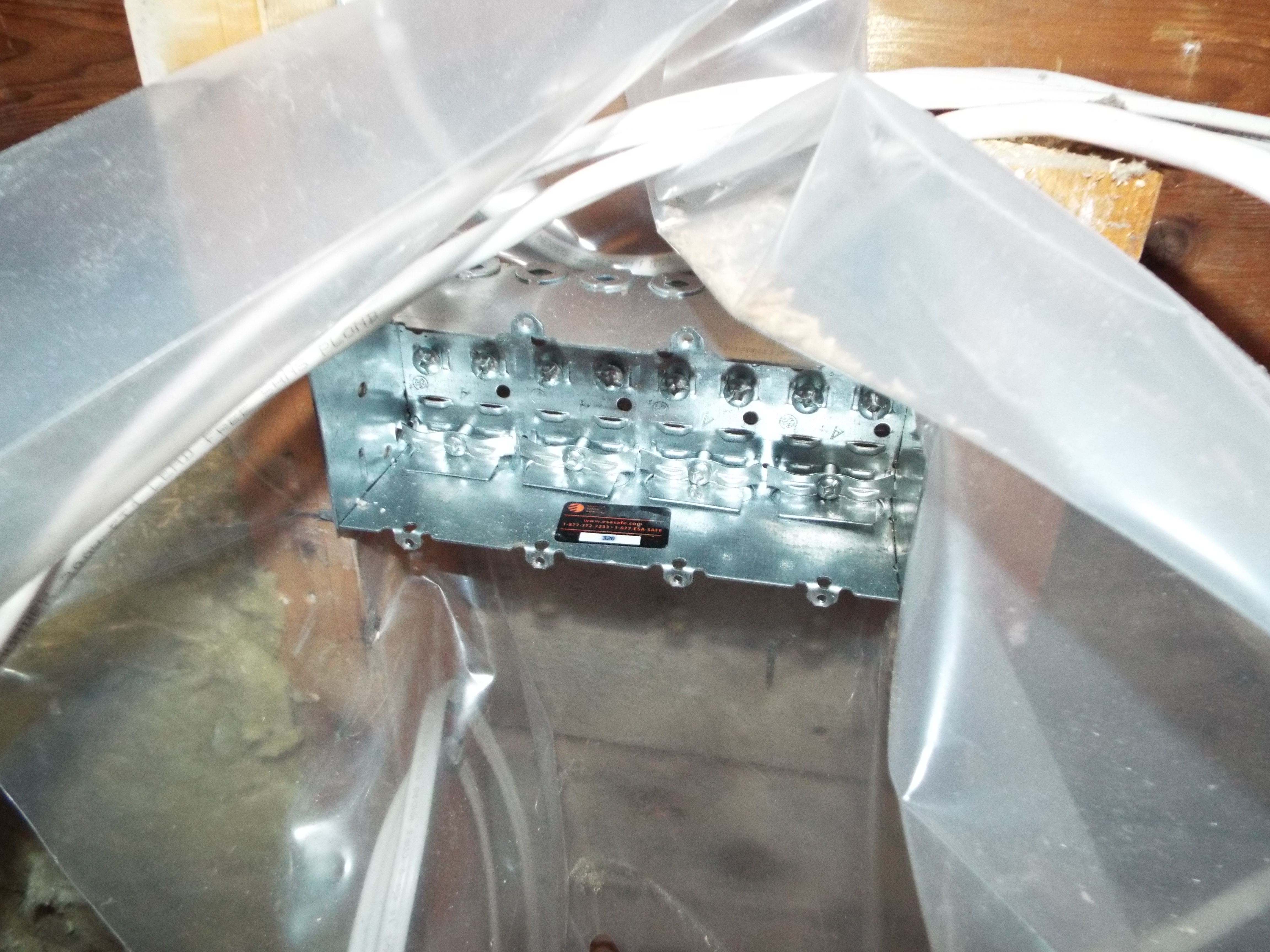

In Canada we tend to use metal boxes more then plastic, so often we find that (especially apprentices who like to use a battery driver for everything) will over tighten the metal clamps inside the box
The same situation at the panel if you are using a metal connector that has some sort of clamping arrangement such as a
or one of theses
The connector should be tight enough to secure the wire, but not so tight that it crushes it or changes it's shape.
