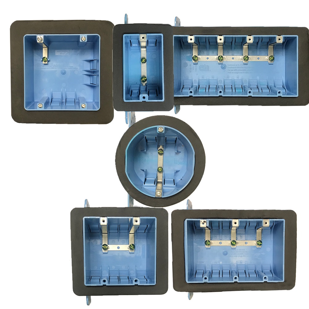

I prefer air barrier poly but you can seal the edges of the wall board and use exterior wall boxes that have a gasket to seal to the drywall.
