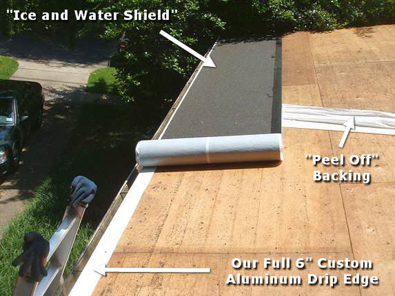

The way the water was getting into the drip edge was where they joined. It was getting in sideways, under the ice and water shield. I had to have him take the right and left side of the porch off and the back 3 feet (both after they were completed) because when I checked, it turned out that he didn't peel the back off the ice and water shield. Ridiculous.

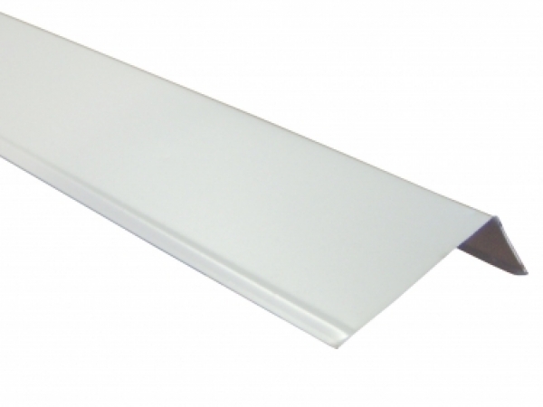

Unfortunately, for whatever reason, most roofers use the wrong type of sheet metal drip edge along the eaves.
He used what is known as an O.D.E., Overhanging Drip Edge, which is made for the rake/gable edges.
A proper Gutter Apron sheet metal should be used at the eaves.
But, even some manufacturers illustrations show the incorrect metal there.:eek:
By being bent at a 90* angle and being placed against a vertical fascia and also a sloped roof deck, the metal distorts and can create a sumped area along the entire eave.
This sump can also occur if the fascia board top portion is too high or alternatively, is not cut at the same angle as the roof decking slope.
Ed

Yes, both from manufacturers of the product and job photos, one in particular that shows exactly the same scenario that this OP is experiencing with the wrong style creating a sumped area in the shingles along the eave edge.
I will try to did them out later tonight.
In the mean time, look at some gutter supplier sites, like www.e-gutter.com maybe without the dash.....
Also, Appleton Metals out of Appleton Wisconsin and possible Rollex might have some pictures too.
