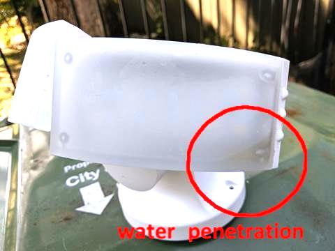

Some years ago I started to transition away from traditional outdoor motion lights and replaced all my security lights with integrated LED fixtures, these should last like 35+ years according to the product listing.
But I have actually replaced quite a few of them since and as I recall NONE of them lasted more than 2 years. My old cheap Copper Lighting clunky motion light that uses two PAR38 bulbs lasted over ten years and it was still working when I went with the new shiny LED fixtures.
I am just not sure these newer fixtures were designed to take the beating. I am in South Florida so yes hot sun high humidity frequent rain sometimes hurricanes.
While the bulbs may last 35+ years, the fixtures doesn't.
The motion sensor is often covered with a piece of fragile plastic in the front. This piece of plastic cracks after being in the sun for a while, letting water in.
Water gets inside the LED light housing. On some of them I can actually see water ponded at the bottom, we have driving rain often in the summers. This is from a fixture flush mounted on the wall and sealed around the perimeter of the base. I don't know if the water is getting in from the swivel arm mechanism, or it may have been condensation, but this light lasted six months before it turned into a disco flashing light.
I tried $39 fixtures, and I tried $129 fixtures, doesn't matter.
I am going back to the cheap basic weatherproof lights with two PAR38 bulbs, and will just use LED bulbs.

Sounds like a serious case of cheap Chinese.
Yeah, the problem is, having the LED emitter last 40 years doesn't buy you much if all the supporting equipment isn't there. Cheap driver with Chinese capacitors, flimsy plastic case that falls apart, RoHS solder that crystallizes... all the details matter.
I've paid $9 for a cheap no-name Chinese 10W yard light, and on the same order $15 for a LEDWholesalers 10W yard light. The difference in build quality was palpable, even with a teardown. The LEDWholesalers has run for 6 years. The no-name quit after less than a year. I know how to swap an LED driver, but the whole unit was just too cheaply built and decayed that there was no saving it.

The problem I think even the brands you mentioned, are in the same boat as the "no name Chinese" brands.
One of those I threw out was an EATON MST18R17L LED security light, also made in China. They don't seem to last long either.
I can't really tell the difference between EATON Chinese VS Big Box house brand Chinese.
For example I bought some made by DEFIANT and none of those lasted more than six months. It's a Home Depot house brand and they are nice enough to replace it with a new fixture, twice, but I am done with replacing the fixture every six months. I called their tech support and let them know the unit failed because water got inside, even if I mounted it flushed against the exterior wall and put caulk around the base of the housing. The tech told me the light fixture is water resistant but not water proof...huh? I did submerge it under my pool!
