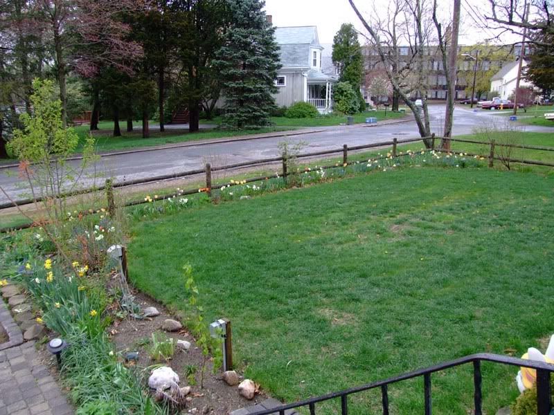

I used a PT 2x4 on a single gang box & a PT 2x6 on a double gang box. I pounded them into the ground before I filled the trench. I did end up putting a little bit of cement near the top to help hold t hem in place
thank you
Thank you , nice yard...
I'm in a snow area, so I also went about 14" off the ground
