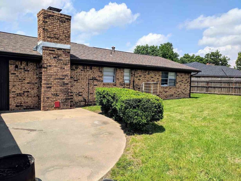

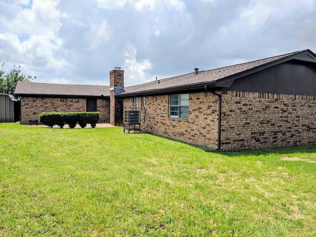

I have a rental house which has issues with water sitting against the exterior wall (slab foundation) after a heavy rain. In once case where 4 inches of rain came down in a few hours, a minor amount of water came in the house. Of course, i am looking to remedy the situation. The house is on a flat lot and it is likely not possible to "daylight" the french drain. I would like to design a french drain/drywell and sump pump system with enough capacity to handle a 15 minute downpour with the power out before the pump comes on to dispose of the water in the dry well. I have 2 ideas detailed below, i hope it makes sense.
idea 1: Install a 1foot wide x 1 deep "french Drain" along the perimeter of the house, this section would not have dirt or grass but would remain gravel around the house for allow for quick drainage. This perimeter drain would be connected to a large "linear" dry well that runs the length of the yard in the middle of the yard (basically a 2 foot wide by 3 foot deep by 50+ feet long trench filled with gravel. At the end of the trench would be the sump basin with a 2" trash pump (high capacity). the drywell would be covered with topsoil and grass
idea 2: similar to idea 1, but rather than have a separate french drain and dry well, the idea would be to have one very large french drain along the perimeter. (imagine a a triangular ditch which starts at 6-9" deep along the foundation and gets deeper to 2-3 feet deep the further away from the house (6 feet or so). Similarly this would run the entire perimeter of rear sides of the house and end in a sump basin. teh outer 3-4 feet would be covered with top soil and sod leaving the bare gravel against the house to aide in fast drainage.
I have posted a photo, if it worked!

I should have clarified that with either of the plans i mentioned some degree of regrading would take place. I would like to avoid having a large swale right in the middle of the yard where folks will be using the yard. Plan 2 does change the effective grade right around the house, Gravel fills it somewhat level but the ground udnerneath has a quite substantial grade away from the foundation. The other issue is regrading the entire yard would also require resodding the entire yard. While an effective solution is required, this is a rental house so "good enough" is also an acceptable solution.

The height of the outside grade does look rather high. How much higher or lower that outside grade is the top of the slab ?
It's pretty dang close to even. I'll do what I can to shave it down lower, but the layout of the property and surrounding properties will make significant regrading difficult. The intent of both of my solutions is to reduce the effective grade well below slab level. It is certainly a complex problem to resolve

Alex, love the house! Wish I could have that kind of brick out here in the Land of Shaky Ground. Alas, after a quake, it would become one of those funeral stone piles.
I'm going to make a slightly desperate out of the box suggestion:
That looks like a new tract, where the clay was compacted for construction. We had a lot of developments like that out here, with similar issues. One dude came in after he ended up with about 5 inches of water in his living room, because it drained the wrong way, and there was no good place to run the water.
So, out of desperation, knowing the top soil was compacted, he, me and a sturdy helper dug deep through the hard stuff on top and hit a softer more permeable layer below. That provided a place for the water to run through, and he was able to avoid further trouble after that.
It was not easy. It was masochism. It would have made a great punishment for someone you really hated. We dug about eight feet. I was 25 then; after, I felt more like 125. Maybe 126.
One reason we decided to do that horrible digging was I ran across a map of by US Geological survey at the library that showed soil types; it turned out that his soil had been graded over another type of dirt. So it was worth a shot.
So, maybe get someone with an auger out to your place to bore down a few yards and see what's there? Or check a USGC map for where you are? Or, just get or force some people to dig and dig and see?
Okay, it's okay to laugh, but it sounded you were getting desperate and I don't blame you.
Let us know what happens, one way or another. Really hope this helps. :vs_cool:
