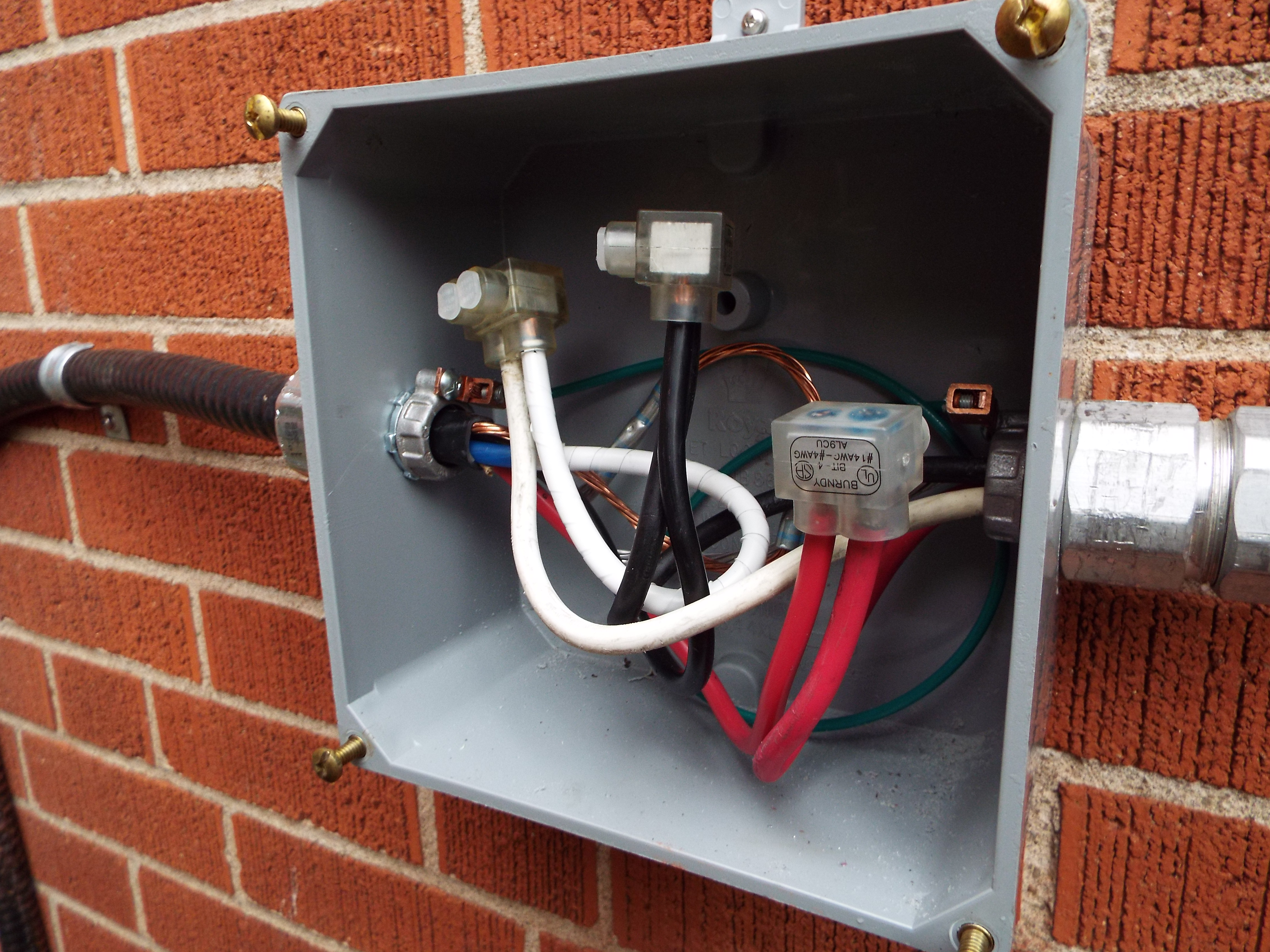

Need some help making sure I ground everything properly and in the past I have not used or known how and when to use a Ground bushing on conduit entering or exiting boxes.
This is for a solar install using micro inverters all 220v wiring.
Main panel (metal) with metal offset to a Shutoff/Disconnect switch (Also metal and I drilled holes in both boxes to make the connections no knockouts were used). Then there is metal conduit run to a PVC combiner box (Enphase Combiner box 3). From there metal conduit run up to roof into a Jbox.
I'm running 5 wires between these boxes.
2 hots, Neutral, 8g Thhn EGC ground and 6g Solid Bare Copper GEC ground.
in the picture the threaded HUB on top of the Disconnect is not installed yet. Didn't have it at the time of pic but that is a threaded hub connection.
My question is at any of these conduit connections do I need to use a ground bushing nut vs. a regular locking nut? Also which ground wire gets used? EGC or GEC?
I see the attached wiring diagram shows EGC gets bonded in the disconnect box (I'll strip back the coating and pass it threw the ground lug in the box already).
Does the Bare copper #6 GEC wire just pass threw the disconnect without any connections and what about the combiner box?

Here is how we would use a ground bushing in a PVC box. You need to both mechanically and electrically connect the metal casing of the cable together. In your case it is the conduit.
The bonding wire inside the cable is the bare copper while the green copper is used between the bonding bushings.

So do I need to use a ground bushing anywhere in this setup?
I thought I read that if you drill your own conduit holes vs. using pre existing knockouts that might require a ground bushing?
I see in the PVC box above they used them on both sides of it. Do I need to use them in my combiner box which is PVC?
3,257 Posts
The general rule is you may use approved fittings made up properly on metal conduit to a metal enclosure to comply with it being grounded except when a connector enters a concentric knockout provision where any of the larger options are still available. The logic being that concentic KO's sacrifice some of the metal surface that is required for grounding. Ground bushing are then required in that instance so that a bond wire can connect from each conduit bond bushing to the metal cabinet. I see no requirement for bond jumpering when using either a hole saw, step bit or punched hole made by the electrician.
As for any plastic unclosures being supplied by metal conduits, bond bushing with a bonding wire running between all metal conduits is required.
