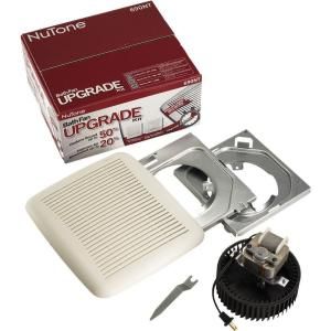

I bought the Nutone replacement kit at HD but the old motor/fan is circular in shape to fit into the enclosure and the new kit has square/rectangular plates to affix the motor onto enclosure unit. in other words, i think this might be the wrong kit? HELP! :huh: a square does not fit into a circle...

You might be able to mount the new motor on the old plate.
But if you don't think so, you should bring the new kit and the old motor and plate back to HD,
also bring the model # of your unit and hopefully they can hook you up with the right thing. If not, just return it and try Lowes.

I'd prefer to just buy an entire new motor + cage (attached). any thoughts?

Now that you have the motor / fan assy. out, take it down to DH or Lowes and if they don't have one they can order it for you.
Looks like sears carries it:
http://www.sears.com/nutone-qt100-q...-SPM2775145802?prdNo=1&blockNo=1&blockType=G1
at $102.00, it might be time for a whole new unit if it's old and dingy.
