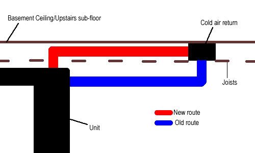

Thanks for the posts. The duct will fit throught the joists (see duct in first pic at top left). I might patch some metal on the side of the return since there is currently only the silver cardboard of the return on the sides and run the two 6" ducts out the side following the same path as now, but drop them into the top of the unit...if you imagine a rectangle, currently the path follows the right and bottom sides of the rectangle where the new path would follow the top and left sides of the rectangle.

Thanks again for the post...here's a diagram of what I mean. The only issue I can forsee would be the return is not totally encased in metal (silver cardboard-like material on sides), so I would have to tac on some for the connection on the side of the return (where the red duct path meets the return in diagram) or also replace the entire return with a full sheet metal return. Thoughts?
Okay, I understand you return sides are not sheet metal but perhaps duct board. Yes, just replace those sections with sheet metal. You may be able to just slide the sheet metal over the duct board. Get a bucket of duct mastic to seal all the small leaks and odd edges that may leak. Can't think of any other issues.
Just wanted to thank you for the responses...I was able to move the duct work this weekend. I used two collars and connected directly to the ductboard with U181 tape to seal any leaks. Photos are below.
