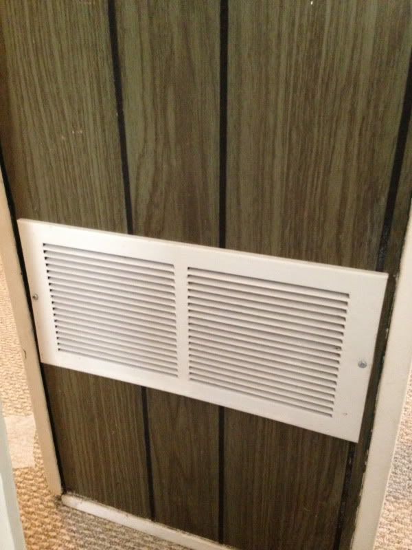

and this is the closet door that goes in front of the furnace with vent that kinda lines up with the furnace and I don't think isn't ventaliting it enough but its been like that for years with no problems but like I said all new windows might be playing a role

Also I wonder if its not getting enough air with just the one little vent in the closet door. Also the house recently got all all new windows so the house is now more air tight and I'm wondering if that has something to do with the furnace and intakeexhaust relationship. I have carbon monoxide alarms thoughout the house FYI.
