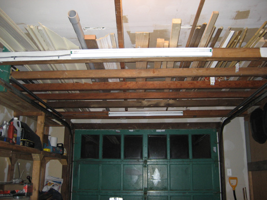

I've got a 1 car attached garage (about 25x12) that I've been using for various projects.
I've been wanting to upgrade the electrical since I moved in about 7 months ago, and I figured I'd do it in EMT. It's rather stupid because the wall I'm installing most of the conduit on is adjacent to the house -- however it's framed separately, and there is a ~2" gap between the back of the framing and the side of the house. It would make a perfect wiring chase for NM-B, making the job a hell of a lot cheaper and easier. But I wanted EMT because, well, for fun. It looks cool too. This is the first project I've ever piped, so please go easy :wink:, or not...
Background
The garage had 2 20A circuits running to it, one for lighting and 1 recept. group, and the other for just receptacles. Lighting consisted of a single 100W bare bulb in the garage, and another in the garage attic. The receptacles are all about 12-18" off the floor, and were always getting blocked by crap I'd store against the walls. A couple are damaged; probably the previous h/o had been doing a project of his own and knocked into them.
The circuits were basically fine for me for the time being -- my highest draw tools are a 15A contractor table saw and a 12A shop vac. So long as I ran their cords to opposite sides of the garage, I'd be fine. (Of course, I couldn't run my compressor at the same time..).
The lighting was my main problem. I'd get plenty of natural light during the day, but at night I'd need to set up portable lights, which is inconvenient at best and they're never in the right place at the right time.
I happened to rip a 4-bulb T8 fluorescent fixture out of my kitchen recently (installed recessed cans in its place), which is plenty bright. So my plan was to put that in the garage, plus a couple of other light fixtures, and also add some more receptacles.
Pics follow. If anyone has suggestions, comments, criticisms, etc., please let me know! A lot of what I've done here I learned from people on this very forum. So if I did a decent job, I dedicate it to all the experts on here. If I did a terrible job, then I guess it's your fault. :jester: (j/k.. I'll take all the blame.) Either way, I hope others can get some ideas for their own project.
Front of the garage. Good lumber storage above, but it makes lighting difficult.
Back of the garage. Good natural lighting and ventilation. I have a couple of window fans I use for cooling and venting out fumes.
My fantastic task lighting. Ceiling is 10ft., BTW.

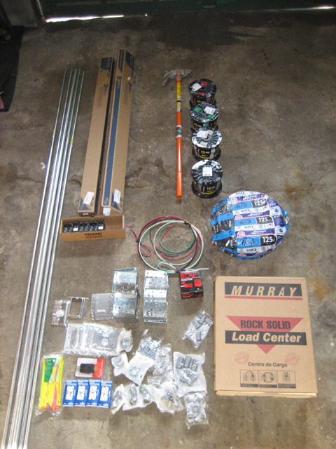

First Home Depot run. Didn't forget much. Figured I'd post this in case anyone wanted to know what brands I'm using.
New main light fixture. Sorry for the weird angle, but it's the only way I could get the full conduit run in there.
Lights in the front. I realized far too late that the one by the garage door gets hit by the door, so now I can't get it open. :thumbup: I'll have to move it back to the next 2x4. Fortunately I did those lights with AC and not EMT, so it should be an easy move.

Details
50A breaker at the main panel (in the basement, about 6 feet below and 6 feet to the left of the sub).
6/3 feeder. (Yes, I bought 125 ft. of 6/3. I just could not bring myself to spend $2.36/ft. when I could get 125 ft. for $136). If you're in my area and you've read this far, I have about 100 ft. of 6/3 NM-B for sale! :whistling2:
100A disconnect at the sub.
Why only 50A, and not 100A+? Simply because I don't need more than 50A. And if I ever do, I can pull a new line from the main panel to the garage. It's a very easy pull. The only reason I'm doing a sub is b/c I don't have space in the main panel for all those breakers.
I'll connect the existing receptacles near the floor to the sub today or tomorrow. The single-bulb fixture is going to be rewired w/o a switch -- I have a 3W LED light bulb that will be always-on. For security, I guess.
All wiring in conduit is THHN/THWN, 12 AWG, 75deg. The NM-B in the attic is 14/2 and will be on a 15A breaker. Existing receptacles were wired with 12-2 NM-B. I tagged the wiring for each circuit with its own color of electrical tape (I used green for one which is probably a bad idea.). Wiring is tagged in every box, even if it doesn't terminate in that box.
EGC is #12, except where it hits a future 240V/30A receptacle; there it's #10 from the panel. I didn't want to use the EMT to bond everything together. I don't have a good reason for that...
If you're still reading this, I appreciate it. I've got plenty of other pics, so please let me know if you'd like to see more detail.

I know you are doing the best you can with the EMT. But quite frankly it looks like a DIY job. You used offsets where you did not need them and then you don't use them to enter boxes. Those two offsets on the right could have been straight pieces, or 90 up over and down. This type of bending is fine for hidden pipe, but not for exposed work. I know you did not ask us to critique your work, but I have bent more EMT than you will ever see, and I just had to comment. Please do not be offended. I have seen much worse, much better and excellent.
This pipe thing takes us electricians awhile to learn. Experience is what makes a good pipe bender. It would be great if you knew someone who is good at it, to show you the little nuances of pipe bending. The things that set your work apart from others.

No worries on the critiquing.. It's my first time working with EMT, so I'm looking for feedback. Like you said, it takes a lot of experience, and I knew that going in. I figured I gotta start somewhere, and the garage is a good place because no one but me will see it (well, unless I post pictures on the internet..).
I thought of coming out the top of the panel, but I figured it would look worse that way. Lack of planning played a part there too; when I laid it out I didn't take into account the garage attic (top conduit), and the fact that the neut. bar would be covering 2 rows of knockouts. (Which is why I couldn't come straight out -- I had to come out of the knockouts ~3" from the wall).
Yeah, that's bothering me too, b/c obviously the conduit isn't lying flat to the wall. I cut and installed quite a few pieces before I realized it (and pulled some wire too), and I'm still weighing whether or not I want to redo it all.
