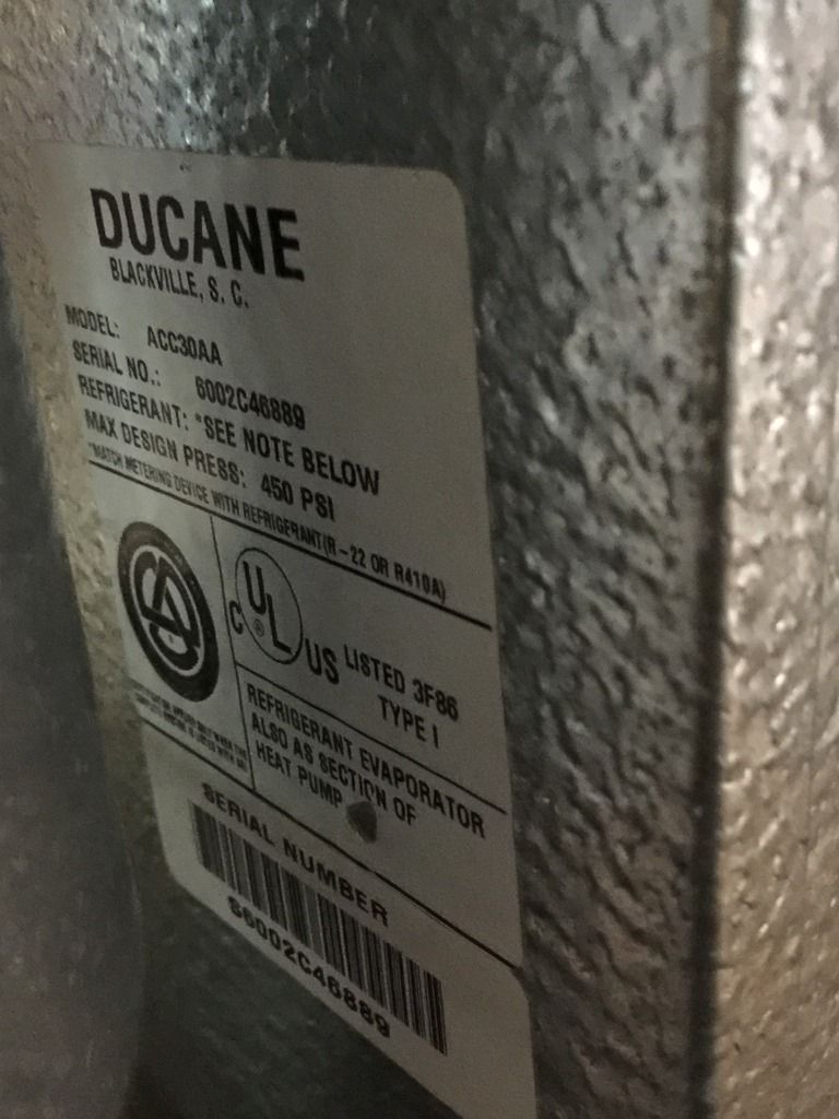

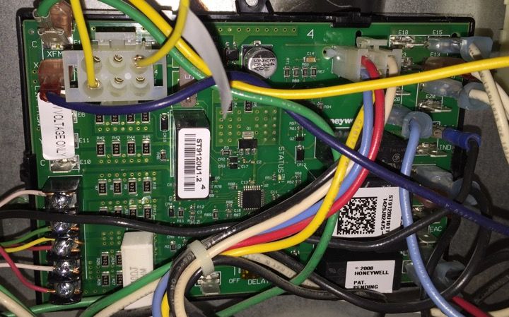

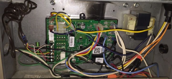

it is a Ducane central air system and furnace. The circuit board is a 2008 Honeywell. I have some numbers on the board as follows, st9120u1011 1429j02475 I also removed the snapped a couple photographs..

17,815 Posts
What size is your a/c or if u don't know, what's the model number?
What's the model number of the furnace itself?
I'm trying to see if it probably should be on high or not.

17,815 Posts
Is that model from the unit outside or the indoor coil? is it the full model - usually the sizing info is after the first dash.
What's the full furnace model number?

17,815 Posts
that's not a furnace model number or doesn't look like one, did it come from the coil above the furnace cabinet or where?
need the number of the outdoor unit and the full number found on the data plate inside the furnace.
Tells me the design cfm of the blower and tonnage.
17,815 Posts
Yes, that's your evaporator coil.
The coil appears to be a 2.5 ton norminal but a coil of one size can be matched to 2 to 3 different outdoor unit sizes.
Circuit board doesn't matter, it's the model of the actual furnace model that's needed as is the model of the outdoor unit. (not the coil)
Need sizes, airflow capacity.
