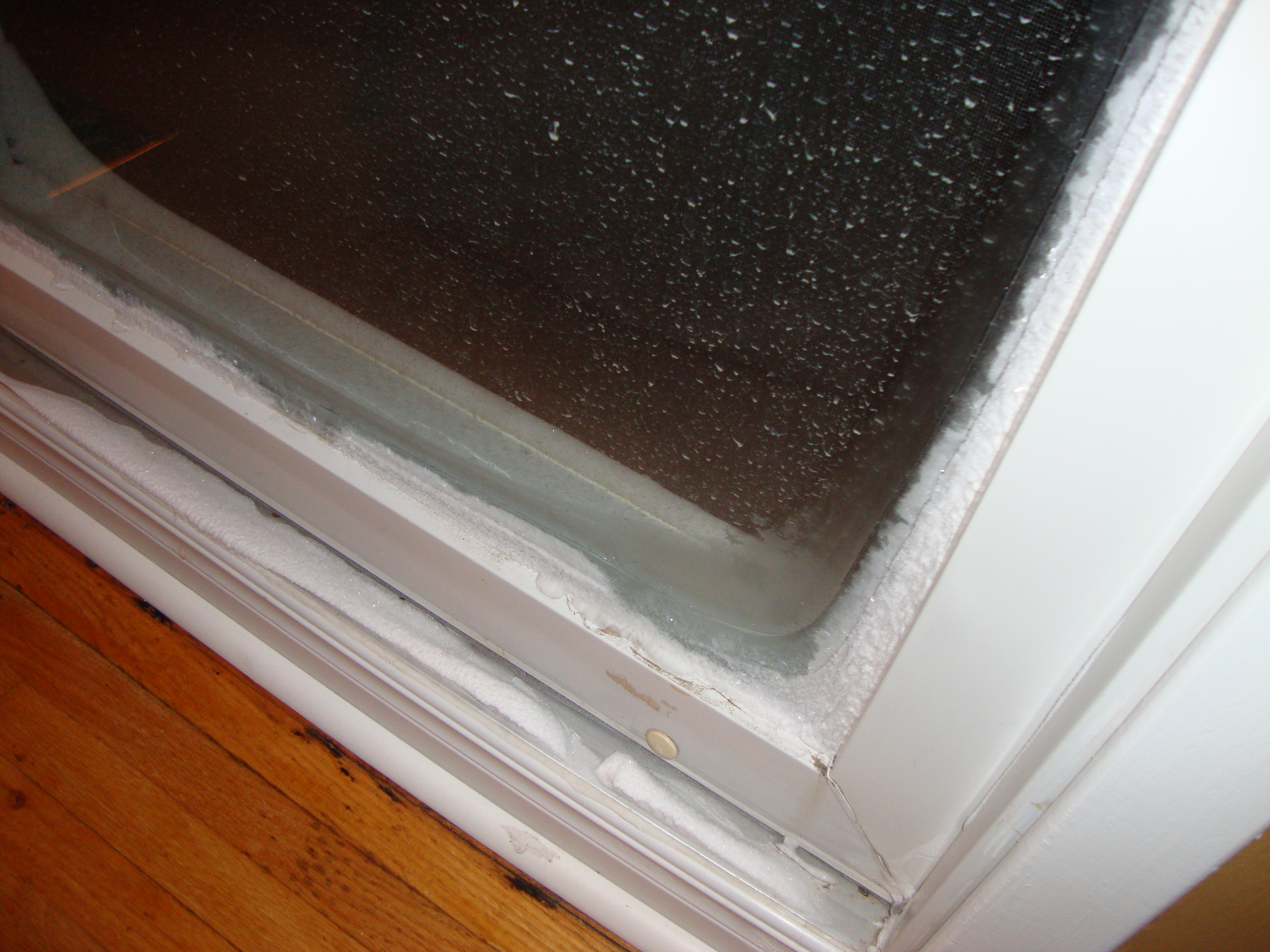

Been in the -30's lately which is standard for this month, we just have not been seeing it much in the past few years due to global warming. Noticed this the other day, did not think much of it given all the windows are doing it too. It's just so cold, and I do have a humidifier.

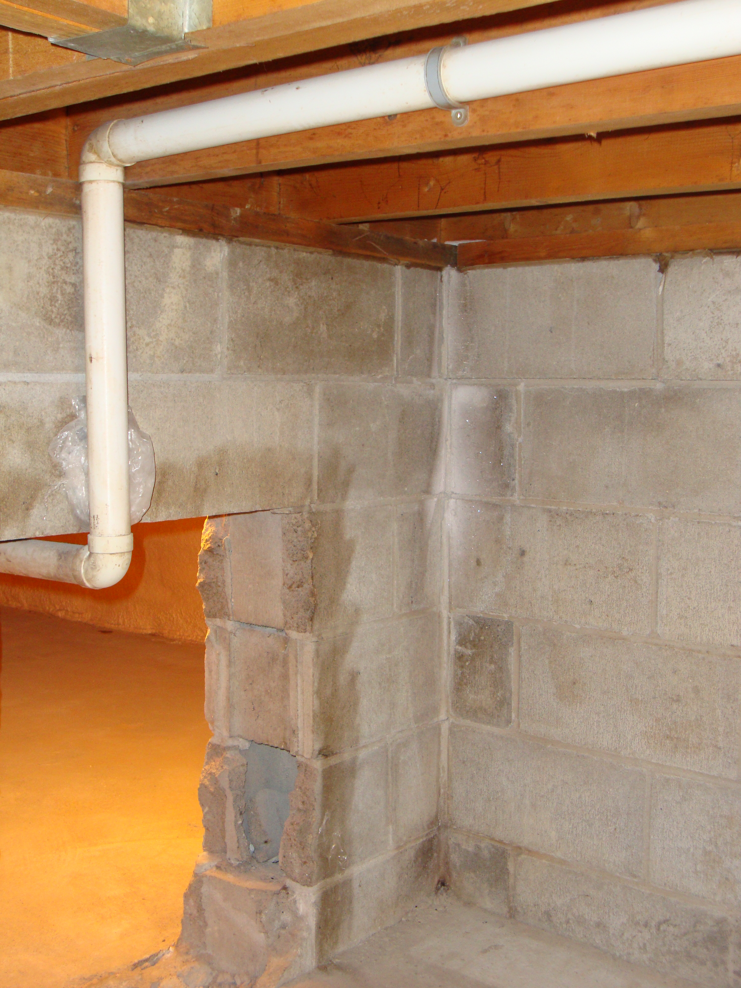

But today I noticed under that area in the crawlspace while measuring for studs/drycore which I want to install:

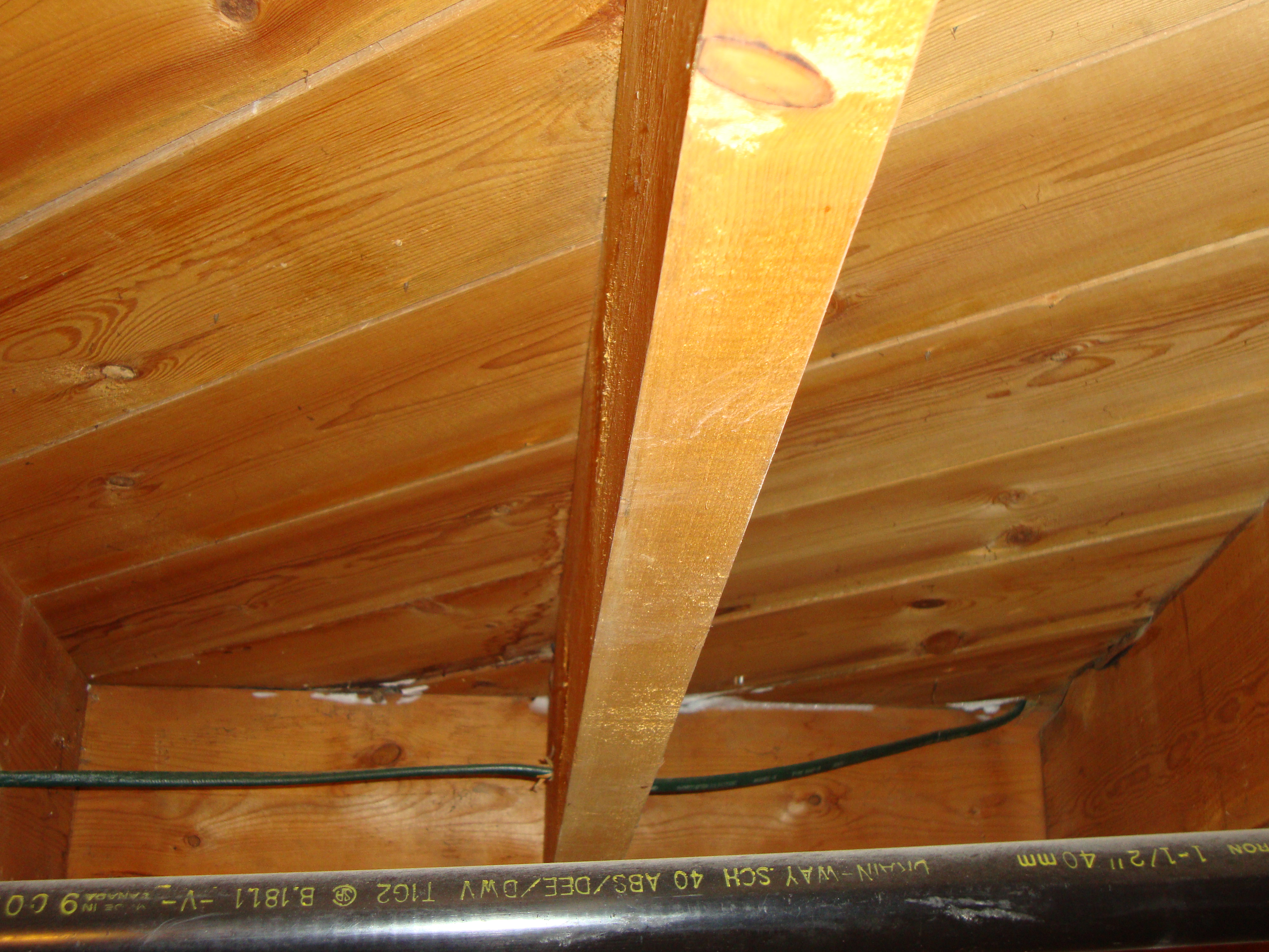

I also noticed another location where it's pretty bad:
I've been wanting to finish my basement, but should I be worried about these problems first? If I insulate that wall, then I will be reducing the heat loss even more, thus it will REALLY freeze badly. Or will the fact that it's sealed prevent frost from forming in the first place? I plan to get it spray foamed after I stud the walls.

To much humidity and not good air circulation.
Glass is just a replacement for a hole in a wall or roof that gets cold and allows condensation. Circulation of air will get the moisture back into the house and cause the preset humidifier to run at a proper level. Air leaks are an obvious sign of localized condensation and freezing. Also, highly conductive materials or pipes (vents, intakes) that can conduct cold air at times can be problem spots.
We only get down to -20F (although -40F could be possible without wind chill) and we got up to 10F today, so we are not as severe and we have a lot of thermal mass in our place to maintain long term humidity and temperature. On windows - aluminum mini-blinds are great at night to eliminate the radiant heat loss that all the fancy gas and films cannot eliminate and still allow circulation.

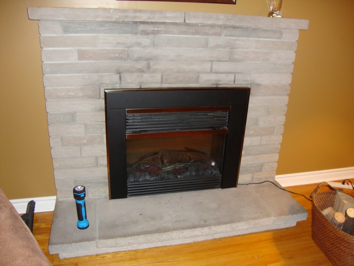

Speaking of frost inside, I decided to pull out the fire place for kicks to see what they did behind there. Nothing!

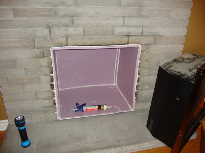

I have a fan blowing on that now to vaporize the ice. What is the best way to insulate that? Can I just use ridgid foam, some kind of glue, and vapor barrier tape for the seams and call it a day? The fireplace that goes there is just an electric insert.
1,950 Posts
Rigid foam inside, against the blocks, (taped), with an interior wall tight against it to hold it, fill w/ Roxul if you'd like to, and sheetrock it; air seal; reduce humidity if it is high; better windows. Options. Doing all is the best, imo, but it ain't my money to do it all.....

Red, we had a fireplace that looked about like that, so I was at a point of adding outside air intakes or sealing it off, and chose the latter. Initially, I closed the damper, lined the back, sides, and top with black foil faced foam (sorry, drawing a blank on the name of it right now), set the rack back in, stacked it with some birch, and it looks as authentic as can be. I didn't have a thermal gun at the time, and have never thought to go back and check it (but may do that now that I am thinking about it), but did hang some tissues in a few places, and it made a big difference in regard to drafts. Maybe not the biggest gap that you have, but a quick and simple fix, and every bit helps.

Rigid foam against a firebox? I dont think that is a good idea. Rock-Wool or fiberglass, maybe.

PS Who left you with maybe 2 inches of bearing for that lintel in your crawl space?

Even with an electric fireplace? Figured it was a self contained unit and did not get hot on the back. I thought of using roxul but wont that get moldy? Or it it only fiberglass that's prone to that? If I go with one of those I'd also need a vapor barrier then right? That fire box is not exactly perfectly sealed.

I ran the fireplace for a while with it sitting outside the hole and it was still very cool to the touch all around. In fact even the part where the heater is was cool, it only gets hot directly in front of the heater, when it's on. The fireplace is more for show than anything. Ended up going with the foam as realized it's already a tight fit as is so would not have room for batts and I'd still have to put a vapor barrier while the foam acts as one. Waiting for caulk to dry then I'll add the vapor barrier tape. I might be able to throw some fiberglass batts in the back though and I might be able to squish it against the sides if there's still some wiggle room.
I'll definitely keep an eye on it for the first time I turn it on though. ;)
At least that's one cold source less to worry about. Only like R3 though but think the air seal is probably more important than anything in this case. The brick probably adds some R value too, very small, but some.
If ever I decide to get a gas fireplace there, then I'd probably have to redo that whole area.
edit: Taped up!
Now a fireplace that does not make my house colder... lol
Of course with my luck it warmed up quite a bit so I'll have to wait and see how good of a job I did when it gets cold again. It's 0 right now, imagine that.
