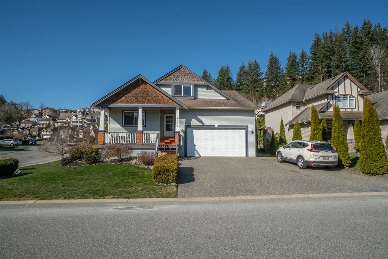

Didn't note all the comments, but things to think about:
- double check your porch can cross your building setback. Usually houses are built right at it, and most AHJs allow the protrusion, but may be limits.
- a hip roof would not match the style of house.
- a sonotube without a bell or footing may not be sufficient for roof loads
- There are many variations in curb appeal which will affect design and detailing. Like if you want a vault over the door. Type of columns. Height of deck and how that affects railings. Width of stair. Picture framing the deck.
- footings within 5'-0" of house need to be as deep as your basement
- step down out of the house is not required
- from your initial decriptions I picture you could do it for $6K in materials. But a porch to match the value of house would be more like $20K-$40K by a contractor (picture gutters, beadboard, skirting, sidewalk, recessed lights).
A dominant front porch will affect your house value to the nth degree, so don't "*******" it on your nice house. So far this thread is focused on details of the floor framing. Start with figuring out what you want it to look like and your budget. Then you figure out the details to make it look like that.
