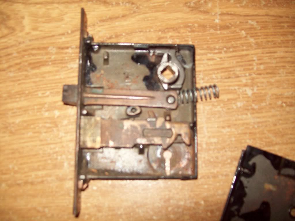

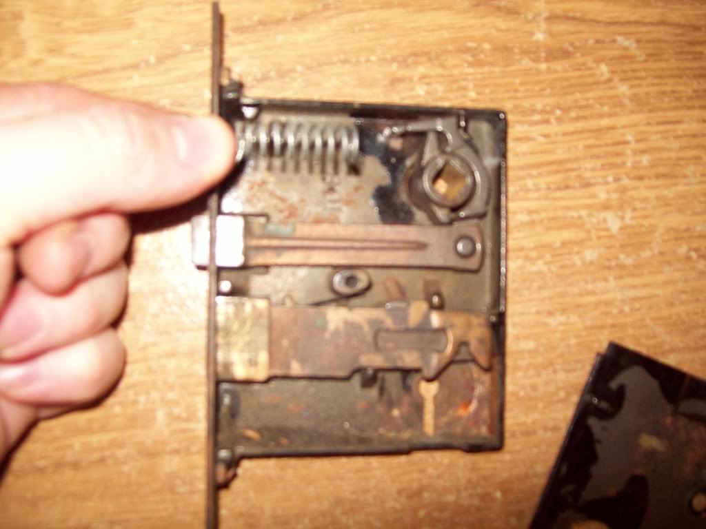

Heya everybody. New here to the forums because I need help with a problem I have. Recently I moved into an older home. The doors and doorknob styles are pretty old, and there's my problem. The living area has two doors to enter and one's mechanism won't allow the knob to turn far enough to let the door open up if it gets shut!
This wouldn't be a problem but we have a dog and regularly shut the doors to keep her from getting into the living room when we're away. I decided, finally, to take a crack at it and what I found was interesting, but I can't make too much sense of it.
The design of the door has it so a large, rectangular recess is actually cut in through the edge, rather than the front and back, of the door. The mechanism is held in by two screws, and when it comes in it basically appears like a big rectangle. One screw opens the whole thing up and, inside, is the following mechanism:
http://i407.photobucket.com/albums/pp157/ARatFlail/New Life/Inside1.jpg
http://i407.photobucket.com/albums/pp157/ARatFlail/New Life/inside2.jpg

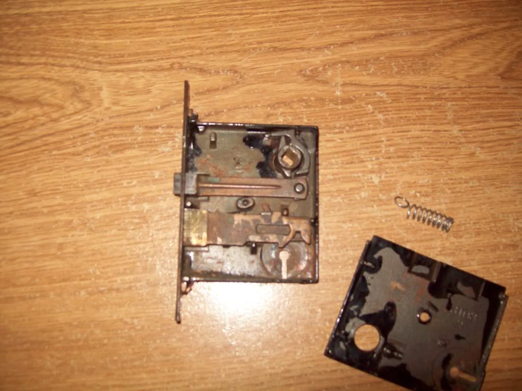

As you can see I have, in the picture, a spring that was inside. This must be out of place because not only was it hanging out, but by putting it back together like this:
http://i407.photobucket.com/albums/pp157/ARatFlail/New Life/mechanismoriginal.jpg
It results in the problem of the knob not being able to turn fully to open and shut the door.
Can anybody give me some aid? I tried to find some pictures of older knob mechanism, but nobody seems to have them. Where the heck DOES that spring go?
Feel free to copy the photos and circle in red where the loop and end go, if you figure it out. It really isn't THAT big a deal to me, but it'd be nice to shut all the doors.

That is a mortise lock, common in houses before, say, the 40's. They were pretty rugged and lasted for years. There are ways to replace them with modern locks(brass plates) without major surgery to the door. But often, people like to keep these old locks for the character they add to the house. While the locks all look alike from the outside, there were several different manufacturers and lots of different models. I am sometimes lucky, sometimes, at getting them to work, but parts are difficult to find. There are two local companies I rely on for parts and expertise. One is a local locksmith that knows of such things, the other is a used house material dealer that really knows those old locks. Check your yellow pages, there should be someone like that locally.

The coil spring was someone's attempt at a previous repair. It is not the original. There should be a large flat piece of springsteel that runs along the top of the case. It would hook above the lug that's cast into the case. It would have a slight hook bent in it. One end would hook towards the face plate, while the other would hook under the cast "L" shaped piece in the top right. That spring serves to extend the latch bolt and re-center the knobs. If you can get some flat spring steel from a locksmith or maybe a gun repair shop, you can fabricate a replacement. Put some light grease on all of the bearing surfaces when you re-assemble.

No, sorry. Not even in the same decade. Yours is probably 1920's-1930's. OP's is late 1800's. Cast latch bolt. No place for a coil spring. Uses a flat spring. Yours uses a wound spring to tension the knob return yoke and a separate spring for latchbolt return. I worked on way too many of these. Many made by Corbin, Reading Hardware, Penn, Russwin and a bunch of others. This is the last I post on this. I explained how to fix it. The coil spring doesn't belong.
