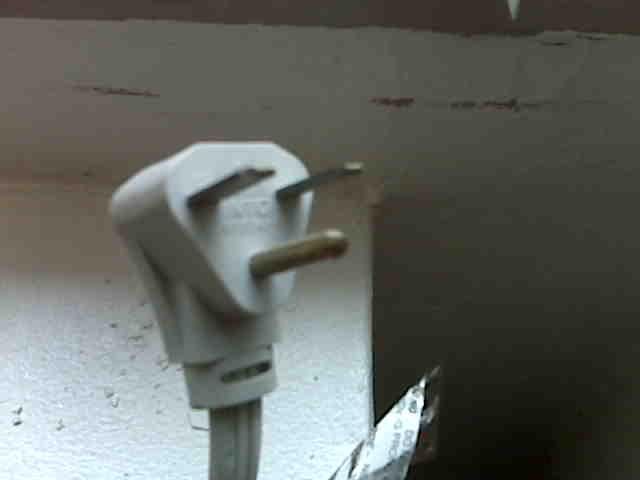

#1 I recently purchased an air conditioner that says it is 230 volt. The problem is the plug on the ac is a 3 prong plug but the two top prongs are paralellel to the floor and not horizontal like normal plugs. I have gone to home depot and lowes and looked everywhere online to find an outlet receptacle that looks like this but I can't find one. Does anyone know where to purchase one online? I'm only finding the huge ones like for a washing machine or something.
#2 My landlord replaced my receptacle in my apartment that was 230 volt with a 125 volt recptacle. Everything I have plugged into this has blown out. Did he create a fire hazard? Whats going on? Can you only repace a 230 with like a 220 and he went down too far in voltage?

Sounds like the landlord just connected the black & white to sides of the 120v outlet & did not change the white to neutral bar at the breaker panel. You probably still have 240v - very unsafe
That sounds like a 6-15R. It's a 15 amp 250 volt receptacle.
And yeah, your LL is a DA. He needs to change the receptacle to match the voltage or change the voltage to match the receptacle.
Yes what Dave has there is a 6-20R which will work

My original outlet did look like that and he replaced it with a regular 3 prong 125 volt outlet and it blew out my orginal air conditioner and anything else I plugged into it. Now I have a new air conditioner but the plug is all wrong. I need to find the right 230 volt receptacle for this new plug and can't find it anywhere

250 volt? But the air conditioner itself only says it 230 volt. 250 volt is way too big. I looked at one in home depot today and those are for like dryers or something like that
250 volt is just it's voltage rating. The receptacle doesn't produce voltage. Your service is most likely 120/240 nominal. You can call it 110, 120, 220, 230, 240. You say sofa, I say couch.

Thank you so when searching for this receptacle online, should I be looking for a 250 volt receptacle? I can't even find a picture of this receptacle to match this plug anywhere let alone find the exact receptacle to purchase. I have never seen a plug like this before with the prongs parallel to the floor.

There are three ratings: 230 V, for the air conditioner. 250 V for the receptacle, and 240 V, the actual voltage in the house. They all mean the same thing. A picture of your plug would be great. Or at least the amp rating of your A/C.
THIS is the receptacle you need. It is a dual rated 15/20 amp receptacle and is standard.

yeah he is not reimbursing anything so I'm out of luck with that one. I can't use this receptacle pictured because the new ac I have is not that type of plug. Here is a picture of the new ac plug and I can't find a receptacle to match it.

The amp says 7.7/8.5

You say the two flat prongs are parallel and in line? That is a 15 amp 240v plug and THAT is the correct receptacle.

Do the prongs look like this?
Well there you go. :thumbsup:
That is a 15A-250v plug.
That plug will fit the diagram/pic that Dave posted. They have them at HD and Lowes. Get a good one.
