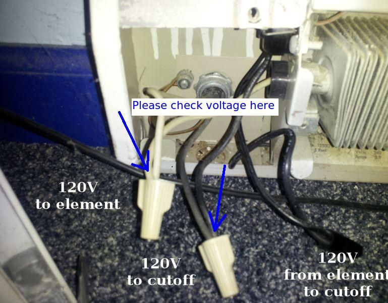

As of recent, the electric baseboard in my son's bedroom is not heating up fully, that is, it gets warm but not hot to the touch. I replaced the thermostat with a programmable Honeywell several years ago and started with this, checking the wire caps and swapping out the "facepiece" with one in the living room. The thermostat shows full power (5 bars) going to the heater (the thermostat can vary the power instead of being straight on/off). I noticed the metal "wire" which runs above the element/fins, which I believe may be a high temperature cutoff, was hanging down on the end opposite where the control is, and reattached it to the holding clips, but still no full heat.
I checked the wires and the white, black, and another black from the opposite end of the element all read 120V at the wire caps. Here is what I have: white supply going to element, black supply to cutoff(?), white from opposite end of element capped to black wire running along bottom of heater and capped to a black wire going to cutoff(?).
I am just stumped as to what the problem may be: bad element, bad cutoff(?). I know baseboards are not that expensive but right now I am unemployed and have no money to replace it if it is something I can fix.

You are probably dealing (95%) with a 220 Volt circuit.
Please be extremely careful.
Is that 120 Volts from each wire to ground?
Did you check between the white and both blacks, and between both blacks? I'll bet you find 220.
Yes, 120V from white to ground and black to ground. All breakers for my heaters are 240V. I did not check from white-black or black-black. The fact that the heater used to easily be able to heat the room to 70 degrees but now cannot get it above 62 degrees, and that before the housing would get hot to the touch, but now I can touch the element fins and find them only warm has me thinking the heater is only working at half capacity. But I am not sure how a 220/240V heater can go to 120V heater.
I am wondering if I should bypass the cutoff and wire the black supply to the black line from the element. Isn't that how 220/240V heaters work - 120V out of phase to both ends of the element?

I tend to be methodical, and would check for 240 at the breaker, then into the thermostat, then out of the thermostat, then at the connection at the heater. If you have 240 at all locations, the heater element is probably gone.
If there is an open or break between the breaker and the heater connection, you could be reading the same 120v phase, one from the breaker side, and the other returning back through the heater element.
I would also check the resistance of the heater element and hopefully you have an identical one to compare to.
Lets say the element shorted out, and caused a poor connection somewhere along the way to melt open, or one side of the double pole breaker to open, or possibly a melted contact in the thermostat.
You seem to have some knowledge, so be safe and do some tracing. Be aware that if there is an open somewhere and there also a short somewhere, disturbing / moving the wiring connections could reconnect them suddenly and unexpectedly.
I would kill the breaker and cap the wires at the heater connection, then close the breaker and check that way.
Also, if my theory is correct, it could have simply been a poor connection that just gave out (with no short).
I don't think there would be a short anywhere unless caused by a mouse, which I do get since I live in a rural area.

How many amps is written on the side of the heater just below the voltage in your picture?
You have a good eye. I didn't even see there was a label. My eyesight is so bad I almost couldn't read the specs.
Watts: 935
Voltage: 240
Amps: 3.9
It may be low wattage, but it used to heat the room easily to the thermostat setting of 70 degrees and I know it would get hot at the element as I found a hard plastic marble from a game melted into the fins and had to pry it out. Now I can grab the fins and hold on without getting burned.
Have you measured 240 volts between the two feed wires (black and white) coming out of the wall? With the heater only lukewarm, is is uniformly warm over its entire length of is one end somewhat warmer than the other?
One thing that can help is an ammeter. The clamp on kind is good enough here and convenient to use here. At 240 volts and 935 watts the heater draws 3.9 amps. (watts equals volts times amperes) At 240 volts and significanly less amps we have a bad heating element; there are multiple sub-elements running the length inside some of which are burned out.

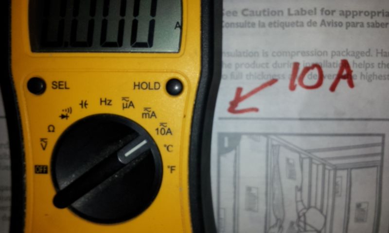

My multimeter has a separate port for amps. It says 10A For 30 sec MAX every 15 min. FUSED (there is a fuse for each "red" port). I wish my organization was better because I have no idea where the multimeter manual is. Story of my life.
Please explain in a little more detail how to test the amps on the heater. Do I keep the load on both ends of the element (white on left side. black on right side), remove one of the loads (white or black), or remove both (in which I would have to assume the multimeter needs to supply its own load)? Option 1 sounds like what you cautioned about, testing from hot to hot so I don't believe this is what you meant. Option 3 doesn't seem right either.
I have done a lot of my own electrical, along with plumbing, automotive, etc., sort a jack of all trades but a master of none. So sorry if I seem a little confused about this, going through a lot of personal crap too. I use the multimeter a lot for voltage checks and some ohm checks, but have never used the ammeter function. Like I said, having the manual would be nice. Time to search the Internet, although I find free Craftsman manuals harder to find than a lot of other manufacturers.

This needs to be done hot, if you contact the two wires you will get a very nasty shock.
Set your meter back up for voltage reading first!
I leave the wirenuts on and stick the probes in.
Just be aware, if they are not on tight they could pop off, just be ready if it happens.
Use of multimeter for amperes (current) measurements:
For this heater, observe the two wires coming out of the wall. One is ultimately connected to one end of the heater element. The other is connected to the cutoff device which in turn is ultimately connected to the other end of the heater. One "loop".
Turn off the power. Remove one of the wire nuts holding one of the wires that goes directly to the heater element (the load). Now you have two loose wire ends. Turn the power back on and then touch one probe to each of these wire ends. What you have now is the power coming in and going to the cutoff device, then through the meter, then through the heater element, then back out the other wire into the wall. Again, one loop and the meter is now part of the loop.
If you don't feel comfortable holding the probes with the power on, you can (with the power still off) wire nut each probe to one of the loose wires. Then turn the power on and come back and read the meter. Turn the power off again and then disconnect the meter and reconnect the two wire ends with the wire nut.
It is a good idea to get in the habit of not leaving the multimeter in the amperes or ohms (continuity; resistance) positions after completing a test.
Sticking the meter probes into two different wire nuts of an intact circuit will not give a useful amperes reading and also increases the chances of making a mistake and blowing out the meter. To do amperes measurements with a multimeter you must break the circuit (such as undoing a wire nut as described above) and then using the meter to re-complete the circuit for a few moments using the two probes.
Using a clamp on ammeter you keep the circuit intact and put the ammeter jaws on any wire without cutting the insulation. This measures the amperes going through that particular wire. For this heater, the various elements -- wires, cutoff device, heating element, are all in a single continuous loop. The number of amperes going through any part of that loop is the same so it does not matter which wire you put the clamp on ammeter on or which wire nut you undo to do the measurement with a multimeter.
