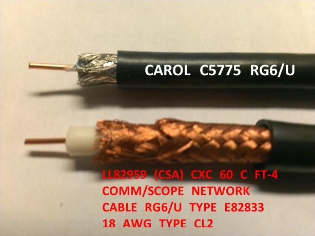

First, I have some RG6 connectors but they don't fit the two cables labeled ""LL82959 (CSA) CXC 60 C FT-4 COMM/SCOPE NETWORK CABLE RG6/U TYPE E82833 18 AWG TYPE CL2". I am using a standard coaxial stripper, tried two kinds of RG6 connectors, and both didn't work.
As you can see, the braided shield around the conductor is very thick. Most of the braid I see has a single layer of strands, this one has it in a cross hatch pattern. They are too thick, especially when "folded back", to go inside the compression connector for the center conductor to "bottom". So my question is, is this a special kind of RG6 and is there a special kind of compression
connectors for it?

As a side note I know why the "LL82959 (CSA) CXC 60 C FT-4 COMM/SCOPE NETWORK CABLE RG6/U TYPE E82833 18 AWG TYPE CL2" cable won't work with my regular RG6 compression connectors. It is larger in diameter then my "regular" RG6 cable.
I have a coil of the CAROL RG6/U cable. I stripped that cable and the thicker one and laid them side by side. The top cable is the regular RG6. The bottom one is the one I am dealing with. You can see it has TWO layers of copper braids and a larger diameter. This braid is so thick I cannot push it into a regular compression connector no matter what I do.
Since it is labeled RG6/U it must be RG6. Weird. I am planning to change them out to regular RG6, unless someone can tell me what connectors to use and if it's better quality then the regular RG6.
The CommScope will not work with regular connectors, because it is a Quad Shield cable. http://www.surplusshed.com/pages/item/m2312.html
I thought quad shield cables have alum foils. Mine doesn't. If it's QS then my cable is actually better than standard RG6? In that case I should leave it alone?
Some do, some do not. All quad shield is good for, is if you live underneath high voltage transmission lines, or getting noise injected from a local Ham operator or radio station.
Standard RG-6 works fine. Millions of installs have it ran inside the buildings and no issues.
