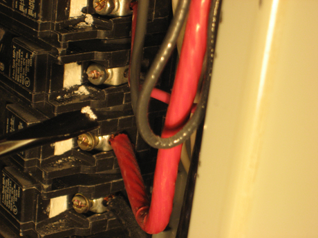

Hi All,
I was staring into my main panel (as one is wont to do), and saw this:
Enlargement:
Two dual-pole breaker modules have this problem (one is rated 50A, the other 20A -- CAC compressor and air handler, respectively). Basically the white stuff you see is flaking off as powder. I'm assuming it's sealant of some kind. You can see some if it on the tip of my screwdriver; I knocked some loose, but there was already a bit that had come off.
Only one other breaker in my panel is made this way, and the white sealant (?) above the terminal is shiny and new looking, even though the unit is appx. the same age as the ones above. (The house was completely rewired somewhere between 1997-2002, so all breakers are probably < 10 yrs. old).
Is this deterioration caused by overheating? Is it just natural aging? And more importantly, should I replace the breakers?
Thanks in advance,
Scott

10 years is not very old.
I would suspect counterfeit breakers.
I know that's not what you wanted to hear. Go google for some other distinguishing marks that counterfeits might have compared to the real ones, and see what you come up with.

I've heard of counterfeit breakers before, and that was one of my thoughts. The thing is, they are generic looking. No obvious branding whatsoever. I'd think that counterfeiters would put a big D on them rather than nothing. (They're Siemens breakers, I believe).
I don't want to risk it either way, so I'll pull both units and replace them regardless.
But could someone who's seen a lot more breakers than myself take a look and see if they look real? (Correct font, markings, etc). I'm very curious, and if they are real then I'm still concerned that they overheated at some point.
Fortunately the rest of the panel is filled out with Square D, so if these are fake then they might be the only ones.
And the panel is Murray, BTW. Not sure of the model off hand. Which brings up another question: Why do I have Murray, Sq. D, and Siemens breakers? I can't remember who bought who, but are they even compatible? [EDIT: Answered part of my own question; should have googled first. Murray = Siemens and they look the same from the top. Gotta pull the units to check the side labels. According to information from Siemens and others, they look OK so far.]

You should try contacting Siemens... these companies are not like retail companies... they will actually listen if you complain. They can either tell you why the potting stuff is coming out, or confirm they are fake. They might ask you to mail them the bad breakers to do their own testing.
You know, I didn't believe you until I got this back just now from Siemens:
Scott,
We have looked at these pictures with our engineering department. These
are definately our breakers and they are not counterfeit. The flaking of
the sealant can occur from contact from the screw driver or something
similar.
If you are concerned about the flaking, you can also call your local
electrician to come out and check on your load center and breakers
again.
Please let us know if you have any further questions.

So the breakers are real (phew), and I guess I can just blame the flaking on the previous installer hitting all 4 breakers extensively with his screwdriver.. (???) Dunno how much I like that explanation because I was able to unscrew all 4 terminals w/o hitting the sealant.
I guess I'll re-install and turn 'em back on.
Thanks everybody for your replies! And kudos to Siemens on a quick response.

It's still plenty crumbly if I poke at it, but otherwise it doesn't come loose from just moving the breaker around.
My main concern was that the crumbling was caused by overheating. Both breaker modules look A-OK except for the sealant. The buss looks shiny and new also..
You think I should still replace them?
