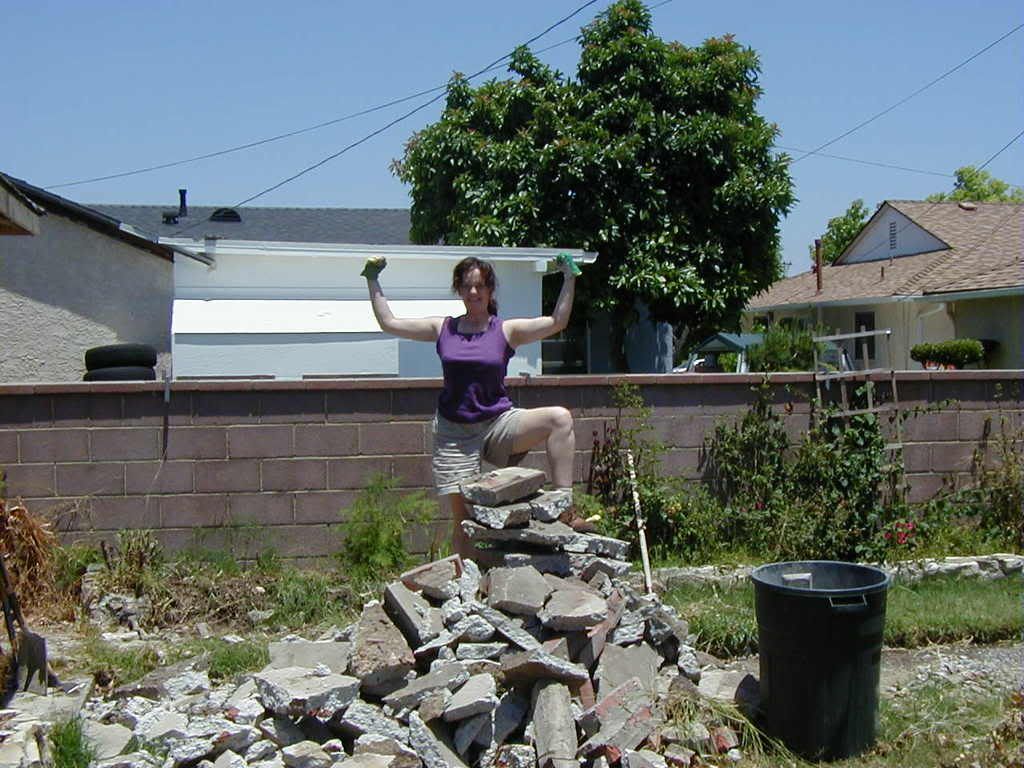

What you have is nothing more than a concrete pad below a clothes line.
We had one at the back of our house.....
This is what it looks like after you break it up.
