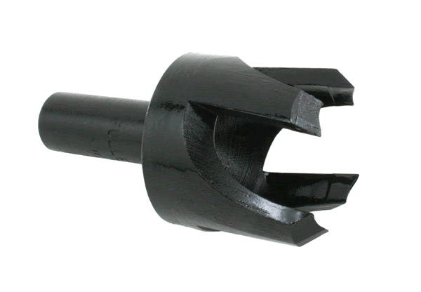

24,974 Posts
I understand exactly what you are trying to do. The plug cutter would do it. You could adjust the chisel in the video to cut a square shoulder by putting it square instead of at an angle.
Do you need shoulders on both ends? You can cut one shoulder on a long dowel and then cut it to length.
Here is a table saw method that I'm sure you could adapt. The table saw part start about 2:45.
