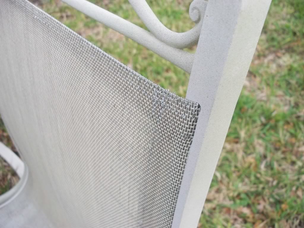

have a bunch of chairs for patio, and framing is still in great shape. But, fabric is rotted. I cant seem to figure out how to re upholster, or if theres another word, redo the heavy duty exterior fabric. It is 12 years old. Pictures are here:

I just cant see how the factory tucked in the fabric. man, what a feat. Howd they do it??? Its like- stuffed into the seam of the metal......cant even rip it out if I wanted to. Whats the secret, people???

Right! I looked closer, and theres a crimped channel that holds a "bead" of the fabric. man, howd they do that?? Howe can one open the channel, beats me, without cracking that "white metal", if its white metal.

The fabric has a pocket sewn in at each side that has a plastic cord that runs the length of the sling. To remove you need to cut sling down the middle then remove plastic endcap from bottom of sling rail, next bend sling backwards at the slot to break it free. Using a pair of channel locks grab bottom of sling and pull out. If you decide to do the project I will tell you how to install new one.

Not sure what you mean by "bend the sling backward". Im thinking only way is to cut with Stanley knife all the way down the length of the channel, then pull sling out, otherwise, its sooooo tightly installed, no way to pull out.......
11 Posts
Cut it down the center with a utility knife then where the sling is in the rail bend the fabric toward the arm on the same side just to break the bond formed over the years. Put the chair on a table and grab the fabric at the bottom next to where you removed end cap with channel locks and pull it downward out the end of the rail. Hope this is clear enough for you.

OK, I did it. Used some soapy water down the channel. Seems like it helped lubricate as I yanked sooooo hard. Now, Bob, how the heck am I gonna install a new fabric, tight and all? Thats the mystery now (after buying it, of course). Im scared.
