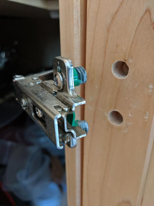

I have a corner cabinet where the hinge came apart. Nothing broke, the hinges just came out of the holes. The holes and the door seems fine.
I think the green plastic seats are broken right? Those were inserted into the holes then the hinge screws bite into those?
Does it mean I need to get new matching hinges (it says SALICE on the hinge)?
These screws will NOT back out.

You could cut a plug if you have the right size cutter or just pick up a dowel and glue that in and use screw. Or get out the knife and whittle some plugs.
9,082 Posts
I don't think brand matters. They are pretty much standard sizes. You can try epoxy, brushing into the holes as well as on the threads. Clamp while setting. I would get 30 minute or 1 hour epoxies so I can take my time working. If epoxy, replacing the hinges will be impossible without damaging the door. Or drill new holes on the side flanges and use #10 or 12x3/4" screws. If screws, predrill holes on the door and hand tighten only.

If the holes are undamaged, why can't I just get new hinges with the new green inserts? Or do you think if it pulled out the holes are already distorted and worn even new hinges won't work and I need to attach using a different method?
These screws won't back out of the hinge body. Do I need to take a dremel or grinder to it?

When you say the screws will not back out, is it because the blue insert portion of the inserts is spinning? If so try putting a pair of vise grips on the blue part and backing out the screws.
If you can't repair the current hinge or find a direct replacement, plug the holes and install a blum style hinge. You will likely have to replace both hinges as the swing of a new hinge might not match the old.

What I meant was, the screws are solidly embedded into the anchors on the other end where the green plastic sleeves. I tried grabbing with a plier and unscrew and no luck. I have since used a grinder to cut then off.

I end up calling SALICE who manufactured these hinges and they are nice enough to send me replacement parts, since these hinges are no longer being made or sold.
I received the replacement hinges today. SALICE told me I just need to "tap in" the new parts then drive the screws in.
This is the part I received.
Even though they said to tap in and screw tight, I keep wondering since the original hinge came off, which may suggest the existing hole may be worn or enlarged? So I am wondering if I should put some adhesive into the hole, before tapping in the part and driving in the screws?
