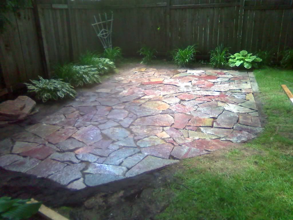

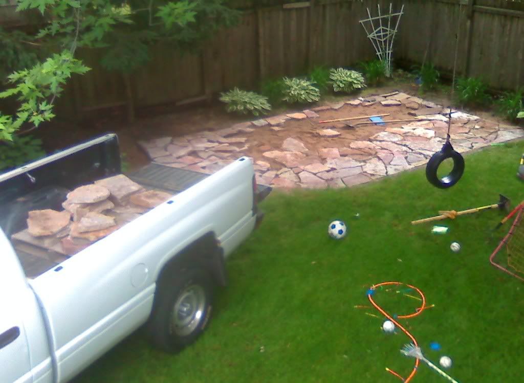

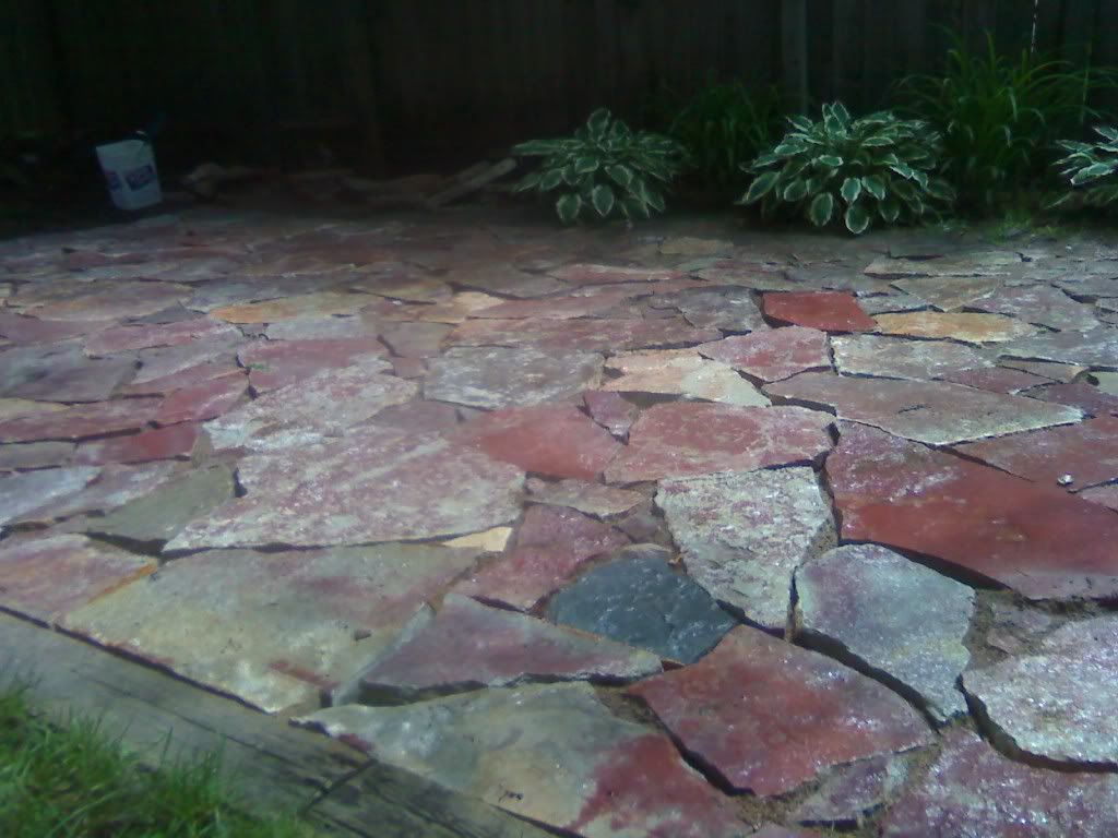

I built my first flagstone patio. It was very simple. I just dug a hole about 1 1/2 feet below grade. then leveled and filled with class-5 gravel. about 6 inches deep. Then filled it with sand about 6 inches deep. Then started laying the flagstone. Final step is to fill in between the stones with some gravel.

I did the same thing but /w a small path. I have yet to fill in between the stones - what type of gravel do you plan on using?
12 Posts
Discussion Starter #5
I just used some pea gravel. It turned out good.I will see how well it holds up. I think you could also use a sand/concrete mix if u wanted something more solid looking. or you could even use some black dirt and plant moss or grass in-between.
