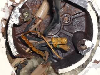

The light fixture in my kitchen needs to be replaced and when I took it down I discovered that the set up has three cables coming into the box that are tied together and has two wires coming down to the fixture. The problem is that the insulation on some of the wires is brittle and falling off, exposing the bare wire.
I'm curious as to what the correct course of action is here safety and code wise do I just cut back the wires and open the cable and piggyback extensions on there? or is there an alternative method that I'm not aware of?
The home was built in the 70's and has the basic two wire 120v cable

Can you post a picture of the inside of the box?
yep!
Full Size Picture
You can see the three cables coming in there and all the grounds tied together. You can also see some of the insulation chipped away on the black wire that is in the bottom left of the picture and that is the wire that used to go down to the fixture. Also, I know that the box is broken on the side there and I planned on replacing it when I climbed up to do the wire work.

Yeah, definitely replace the old box and secure the cables properly. If you use a metal box, then also connect it to the grounds using an approved bonding screw. (Not sure if the bond screw on the fixture's bracket, if it exists, would meet the requirement.. hmm..)
The black conductor in the lower-left: you said that was wired to the fixture -- it's hard to tell, but it comes out of the "romex" (or whatever brand of NM) in the lower-left, outside of the pic? If the sheath of that cable is stripped outside of the box, that has to be fixed too. IIRC you need 1/4" - 1/2" of a cable's sheath extending into a box.
Because of that, you can't just re-insulate the conductor.
If you have some slack on that cable, you could pull it into the jbox so that you can cut away the damaged wire/insulation, re-strip, reconnect and you're done.
[Woops, just wrote another paragraph and then realized you said that the attic is right above there].
From above, you can just cut the damaged wire back a bit (1 ft, 3 ft, whatever). Run that old wire into a new jbox, and run new NM-B from the new jbox to the fixture's box. Connect black-black, white-white, gnd-gnd-box in the new box, and you're back to normal.
Oh, and from the looks of it that's a switch leg (?) and the white conductor is hot too -- if so the conductor should be marked with a color other than green anywhere it's visible in a box (using a sharpie or electrical tape).
Yes, that black wire comes right out of the cable.

No, actually this is exactly how I found it, minus the e-tape that I wrapped around the wires. I've seen similar crimped copper cuffs around other parts of the house too and you can still buy them!

Yeah, I'm surprised too. Like I said earlier, I've torn apart other parts of the house and all the rest of the wires were fine. You can tell in the picture that the insulation is right up against the box (something else I'll fix while I'm up there). Maybe that has something to do with it? I have no idea.
So, it sounds like cutting back the cable to a point and feeding into a J-box above with some new NB and a new fixture box is probably the safest, best way to go. Thanks for everyone's input! Very helpful! :yes:
That is the best solution. And it will not prohibit you from using fixtures requiring 60ºC wiring if you feed the box with NM-B.
