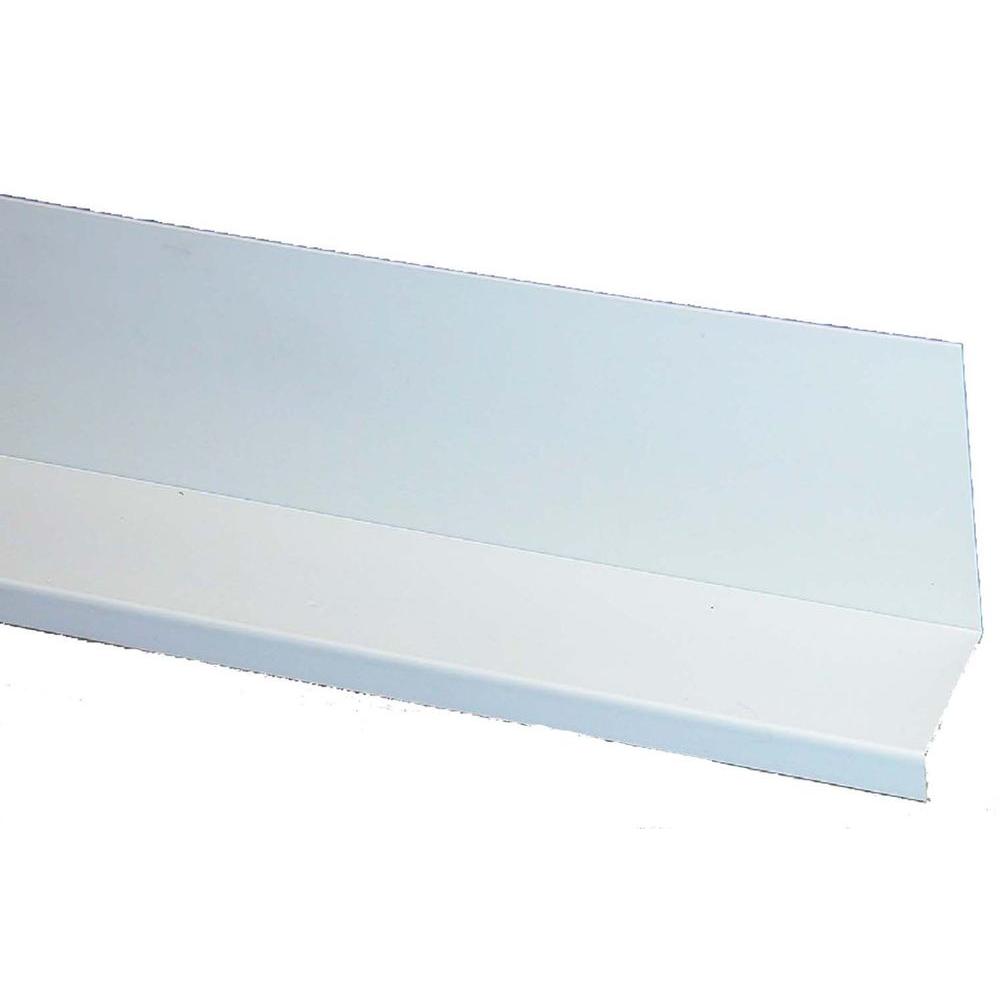

I would raise the door with a 2x6 under it so you can do a flexible flashing and continue the flashing around the bottom of the sheeting and 1" of concrete.

Run the flexible flashing on to the adjacent concrete by 1" with a primer and than cover that with a metal flashing.

All the sliders we get here are flanged windows that are 3/12' thick so we set them on a 2x4 flush with the outside of the sheeting .
Most time we have a concrete wall below that and we put the flexible floor pan down onto the concrete.
As you have a level slab you would come out onto the slab 1" to 1 1/2"
Then you would install the door.
Then a metal flashing for the whole wall and below the door.
