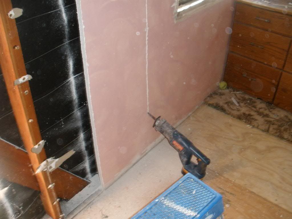

If it a basement, walk out or not, the walls are unlikely to beload bearing--do check--
Your sawsall is the best tool to keep handy --install the blade upside down--this makes it easier to make shallow 'skim' cuts in drywall without cutting deep enough to damage pipes and wires.
Also--it is usually better to cut between the plates and the studs---and cut off the nails--
Have fun!-Mike-

Make that cut like Mike says, then you can pull away larger sections of drywall. I found cutting between each stud bay like Mike suggested gives you pieces you can easily carry....and fits in the trash can.
If you get the wife or one of your kids to hold the shop vac near the sawsall while you cut, you will drastically cut down on the dust.
And....put a chunk of carpet or a rug near the steps. It will catch a good % of the dust before you track it into the main house.

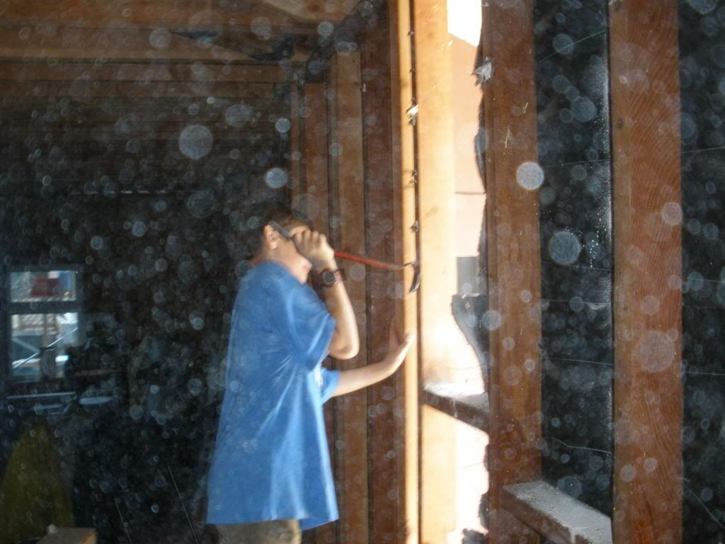

My oldest son got to pull all the nails out.
Those white spots on the picture? Dust on the camera lense
