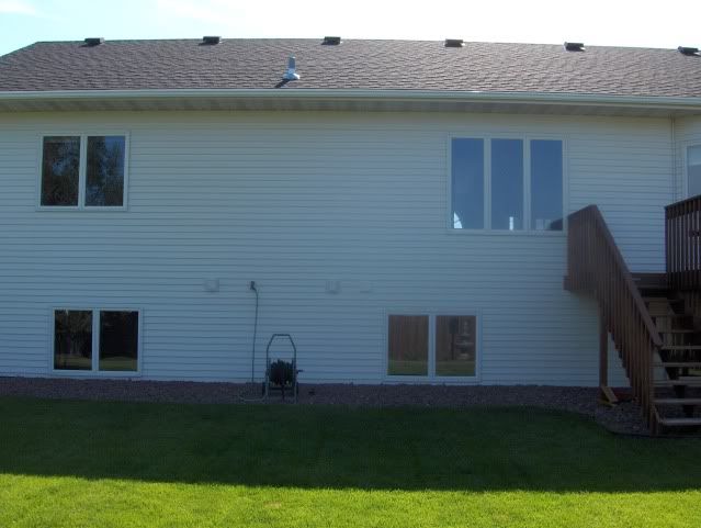

OK...got some pics now:
Overall view of west side. Leaker is lower-right window.
Lower-right of NON-leaker...

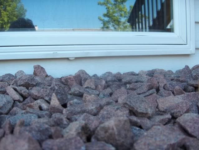

Caulked LR of leaker...
Closer view of caulking (just above scratches), just below window casing/in J-channel...
View of J-chnl caulking, with rubber cane-tips holding siding back.

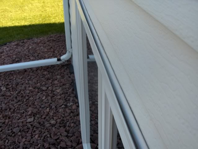

Caulked top of leaker, with rubber-tips holding siding back, and caulk applied...
Lower bedroom where water leaked onto floor. Slight hole cut out behind trim. Drywall NOT wet!! Scanned with a moisture-tester. Water must be coming behind the foamboard insul.

The siding shouldn’t be buried like that, it can cause you some big problems.
You need at least 6” between grade an the bottom of the siding.
Good luck with the band aid.
310 Posts

Siding isn't actually buried, although it looks like it!
There IS only about 2"-3" below siding b4 the dirt starts though....
The rocks take up the rest of that space, making siding look like it's at dirt level...even though it's CLOSE!
>>> Do ya mean rain could've been blowing UNDER the lowest siding piece??

It appears that you have a block or concrete foundation wall that is just about the same height as your grade. It's common practice and code in many areas to have a minimum of 8" from top of foundation wall to grade.
Burying the bottom edge of the siding lends itself to moisture problems and possible insect infestations as well.

* As in the pix, the siding below window had a "bow" towards the front. Both above and below window.
* Thus...I had the idea to use the rubber cane-tips to easily push back the siding to contact the windows' flanges/sheathing.
See this pic, where siding has been sitting for years...nearly touching back of top J-chnl....
Here I am pushing siding back to contact sheathing/etc.
It's the same way UNDER each of the windows, where I was blasting the water.
Could this "bowing forward" of the siding underneath leaking window allow water to come under siding and OVER the foundation?!!

It looks as though the siding above the window is behind the J-channel. This should not be. You should never need caulk on the top J-channel. The top J-channel should be continuous across the top of the window with down turned legs at each end leading into the jamb J-channels. The nailing flange of the J-channel should always be behind the siding. The jamb J-channels should extend to the bottom of the sill J-channel.
The common misconception with construction today is caulked joints. No matter what the warranty, no matter the installation, caulk fails. All openings and joints should be flashed to expel water without the use of caulk. Caulk should only be used as an enhancement of the installed flashing.
To fix your leak I would remove the siding around the window, install rubberized flashing and correctly install the J-channels.
Also, as many others have said above, get that dirt away from the top of foundation. It is a code violation and is leaving you open to mold, rot, and insect infestation (especially termites if you're in their zone).

The fact of the matter is, the siding is nothing more than a water-shed, to carry away the majority of water.
As you can see, the siding inside the J-channel at all 4 sides of the window is designed to float freely. This prevents distortion of the siding due to expansion of the siding material.
The reality is, the substrate, in conjunction with window and door installation, as well as flashing details, is what keeps the water on the outside of the building and out from between the WRB and the sheathing.
If you were able to force a leak with the garden hose by spraying it against the siding/accessories/window, there is a failure somewhere in the preparation stage of the project.
Moisture will find a way behind the siding, period.
Whether it be from condensation, migration or precipitation is irrelevant.
With grade so close to the top of the foundation wall, it could just as easily be splashing up behind the siding and being drawn in by differences in pressure due to the wind.
