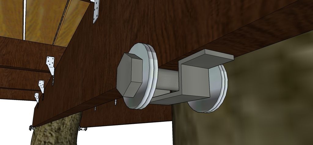

I have been looking around the internet for a couple of months, and I ended up with the following layout for a treehouse platform. I have some experiance in light DIY projects but it will be my first time for something that big and complex. So any advice on anything looking wrong would be great. It is based on what other people around the web have used for similar size treehouses - other than using steel string instead of knee/diagonal braces(there will be 4 strings - picture shows only 1 of them).
Platform surface is roughly 6.5' x 6.5' (2.2m x 2.2m) plus a small deck
Parts (from bottom to top):
- 4 x lag screws 3/4"x12" (20x300mm)
- 2" x 10" main beams, 10.5ft long (3.5m)
- 3" x 6" parallel beams (with the eyebolts)
- 2" x 6" vertical beams (no eyebolts)
- joist hangers and rafter ties to join all the beams
- 1" x 5" planks for the floor (I already have them in stock)
I have not decided yet on the size of steel string, eybolts and turn-buckles. A rough calculation of empty (without people) weight is 1000 lb, so I guess buying components so that each can bear 1000 lb will be ok (there are 4 of them so all combined will be able to hold up to 4000 lb i.e the empty house, people on it plus a big safety margin).
Pic1: Platform layout. 4 strings (picture shows only one of them)
Pic2: Bottom of platform, under the small deck
Pic3: The real trees with a test plank (for measurements)

Ayuh,.... What's the detail of how yer attachin' to the trees,..??
Ya know there'll be movement,..??
Also gotta be careful not to damage the bark, 'n girdle 'em,.....
The picture below shows the details.

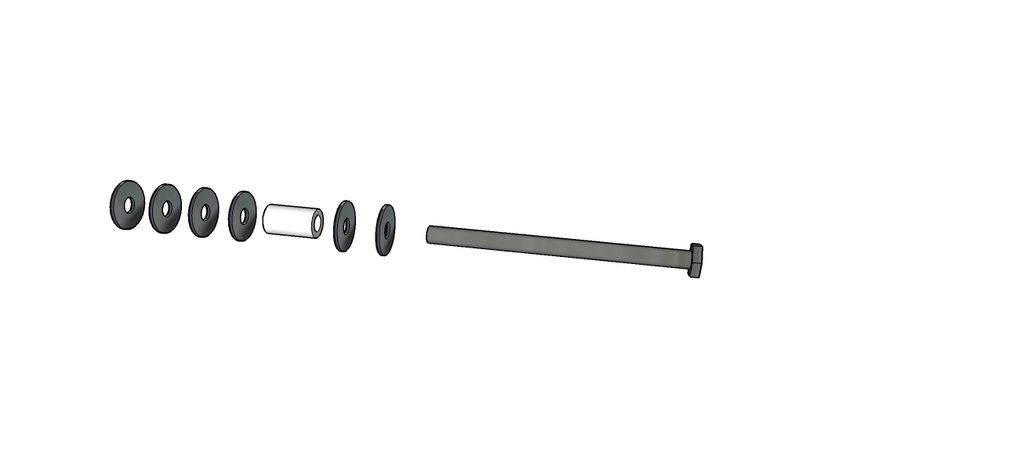

The tree is 20" (50cm) thick, but it has a thick 2" bark that is brittle. The plan is to use a hole saw all through the bark and then put in the hole some spacers. I will also use a short length of pipe for the part of the lag screw that will hang out (and support the beam). So, out of the total length or the lag screw (12") the first 7" will be inside the core of the tree, the next 2" will be inside the spacers to account for the bark and the last 3" will hang out and support the beam.
These trees can handle more abuse than this. I also asked the local agriculturist just to be sure.

That is a layout to fail. There is a reason that those companies that professionally build tree houses, have special hangers and understand that the tree is a living object.
No city is going to let a treehouse held up by wires and turnbuckles to pass, since they have started to be more alert on these items, then how it was in the 70's and before.
This talks about the right and wrong way to build a treehouse. http://www.treetopbuilders.net/fasteners/
These are the bolts that are used for attaching the structure to the tree. http://www.treehousesupplies.com/Treehouse_Bolts_s/41.htm
I didn't know about these sites 10 years ago when I built mine. I used long lag bolts. I figured they are good enough for attaching a deck ledger to a house. Had I known about the specialized hardware I would have opted for that-much safer, and easier. Only half the weight of my house is borne by the lags though, the other half by the diagonal posts. After 10 years, the tree has begun to grow around the beams, even if the lags failed it can't go anywhere it's part of the tree. As far as code goes, I doubt any tree house, regardless of how well it's built, is legal in my town. You should look into that or be ready to take it down. Mine has survived two hurricanes and 3 boys.

I do not like the lag bolt attachment in the photo in post #5. Lag bolts are designed to be pulled up tight. They are rated for tension and shear. I have never seen a rating for a lag screw bending with x inches of projection.
The other thing is that strap underneath. What is the straps resistance to bending and what are the screw attachment pull ot ratings on it ?
It looks like a "close enough for government work" type installation rather than proper design.
If you get a lifting moment on that platform either by wind loading or failure of another point of support, will it really hold the platform in place, or does it fail allowing the platform to tip further ?
I think I would toss that design and reinitiate my search for a better design. Or go to your backup plan and build the playhouse on the ground.
Thanks for pointing this out. I had in mind something like a 1/8" thick strap attached with 1/4" lag screws as this part won't bare any load.
But if the platform lifted there would be a serious problem...
Just for the record...If the lag screw is pulled up tight against the tube & spacers as in the diagram below,assuming a tight fit in the tube and all threaded length of the screw is in the tree, is it still considered as projecting?
