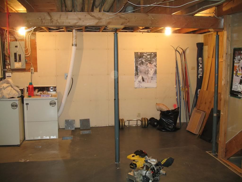

I just bought a 30 year-old two story semi-detached home. There are three houses attached together. I’m in the middle; I share a wall with one neighbor and my garage shares a wall with my second neighbor. The foundation is poured concrete on all sides (including the wall between me and my neighbor) and the floor slab is 7 inches thick. The foundation is in excellent shape, and there are no cracks in the foundation or any of the walls throughout the house. However, it appears to me that my neighbors have sunk very slightly. There is a noticeable bowing in my living room floor (i.e. it slopes towards the edges). The parquet flooring in the living room makes it rather obvious. This distortion is not transferred to the top floor. In the basement it’s apparent that the centre metal post is higher than the walls. It might not show up very well in my photo, but the beam is higher in the middle (over the metal pole) than it is at the walls. The building inspector who examined it didn’t think it was unusual or a problem.
I’m wondering if I should adjust the pole jack. I realize this may cause some settling and cracking in the upstairs walls. Does anyone have experience with this? I'm assuming just a few turns would do the trick. I’m renovating the basement and will be walling in the pole, so I will not have an opportunity to do this later.

A level and some close measurements will help you decide on how much to lower the support. Make small adjustments 1/4" at a time and let each adjustment settle for a week to help avuid cracks.
79 Posts
Keep a string line attached from end to end on the beam as you lower the middle to help make sure you don't go to far. If that column is supporting more than the floor, a 1/4" at a time might be to much. And judging by the pic., you might be adjusting both columns there because I don't see the right end of the beam - how far past the right column is the foundation wall that's supporting the beam?

Thanks for the replies. I had intended to do it a small amount at a time over a couple of months. Is it simply a matter of turning the nut counter-clockwise with a wrench?
The beam ends at that column - there's a stairwell coming down there (the foundation is a further 3 feet to the right). The left end of the beam rests directly on the concrete foundation (I assume it continues into my neighbor's place).

you can lower it slowly just turning the nut, but expect cracks even if you take a year. The old cracks from it getting to its present shape have just all been calked over time.

I don't mind the cracks too much - I'll be renovating upstairs after I finish the basement so it's a perfect time to do it. Incidentally, I ran a laser level along the beam and found it is deflected upwards about 1.5 inches.

Good question. I live in northern Alberta (56 degrees latitude) and frost heaving is a potential problem. However the floor is 7 inches thick and I haven't found a single crack. Having said that, the basement floor is uneven. I suspect that the units on either side of me have sunk slightly. The wall I share completely with my neighbor has sunk more than the opposite wall (to which my garage is attached). My measurement was relative to the shared wall - i.e. the shared wall appears to have sunk 1.5 inches relative to the top of the pole while the other wall appears to have sunk only half an inch.

Hi. Just thought I'd let you know I lowered the posts a few weeks ago and I'm happy with the results. I actually did it all at once and have yet to see any cracks in the upstairs walls (which is surprizing). It's made a noticable difference to the level of the floor upstairs. More importantly, the floor is now much quieter with far fewer creaks and pops. I couldn't get rid of the bowing completely. What seems to have happened is that the unit next to me has sunk a bit and the foundation between us is acting like a lever, pushing the beam upwards in my unit.
