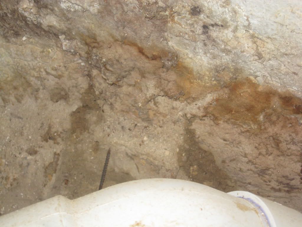

What are some ways to deal with this? This is the only spot in the basement where water comes in, at floor level near the back corner.
I will add some pics of outside tomorrow. Thanks for taking a look.

Kinda hard to tell where it coming from, Most obvioius thing to me is the plumbing. make sure it not leaking. It looks fairly new. Is there and cracks in the wall near there? I cant really see in that picture.
Thanks for the reply.
I know it looks like it might be coming from the pipes, but its not. I don't think there are any obvious cracks, although I will have to take a closer look and some pics. After a decent rain, the water seems to seep in where the floor and wall meet.
that's called a ' cove ',,, the better builders install good waterstop while other's use less expensive & some don't at all :( go figger,,, if you're lucky, injection w/hydrophyllic polyurethane will stop it from the inside - call a pro ! ! ! otherwise, the only way to stop it is excavate outside,,, that's it ! ! !
wish there was better news but there ain't ! ! ! :huh:
Here is an up close of the wall where I believe the water is coming in...and as mentioned above, I will probably need to call a pro. Any idea what it might cost to fix this?
IF you can find a local listing for ' concrete repair ' in the yp's/google/etc, i'd suggest going that route,,, calling a waterproofing company'll probably result in the salesman ( inspector ) pushing for a french drain which won't stop the wtr - just manage the leak,,, we have a min of $500 for 1st 2.5 hrs INCLUDING equip & 5gal of injectible stuff bang ports included.

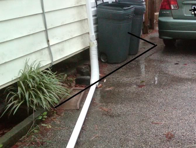

After making sure the gutters are clean, adding an extension to the downspout, I am reasonably sure the issue is the grading of the driveway.
I am wondering if, instead of having the driveway regraded completely, I might focus on the area within the black line. Maybe build it up and create a slope. Water seems to pool in this section and it is near this spot that the water is coming in, albeit at floor level in the basement.
I suppose you could try to fix it that way, remember though, the rain off the siding wall above drips down inside your new perimeter curb, concrete slabs are porous letting water in and through them, capillary action of the water under the slab will still enter the basement there due to ? (less dense soil, air pocket cavities, etc.) who knows without excavating and a proper fix......

If I were going to do this the "right way", am I correct that the driveway would need to be dug up? and accessing the area under the house seems difficult.
I guess difficult for me, but not for a pro.

I think you basically answered your own question.
You have to get the water AWAY from the house. That includes making sure your gutters are functional and clean, draining the downspout so that it goes away from the house, etc.
If the surface of your driveway has water running TOWARD the house rather than AWAY from it, you've got a problem. The RIGHT way to solve the problem is to replace the driveway. But since you probably don't have the bucks to do that, you'll need to figure out a way to get the water to run down the driveway and away from the house.
