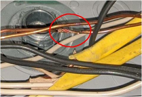

I had a short, caused by my being galactically stupid stupid stupid, well at least I am still alive.
I thought I had the panel turned off. Well I did. I then turned it back on for a second to open the garage door, then a phone call distracted me, and I forgot to turn it back off, and I proceeded to do stuff as if power was off!!!
I was in the middle of doing some major reorganization and rewiring in this 200A Siemens subpanel. I have added a new 3/4" EMT conduit connection at the bottom of this panel and I was pulling some new THHN conductors from a junction box into the panel. Some bare copper ground conductors got in the way, and I wasn't paying attention as I pulled the new conductors in, they shifted the positions of the bare ground copper conductors and they made contact with the metal bus at the bottom. A loud pop and everything on this side of the house connected to this subpanel went off.
Here you can see a close up where the bare ground conductors (two of them made contact).

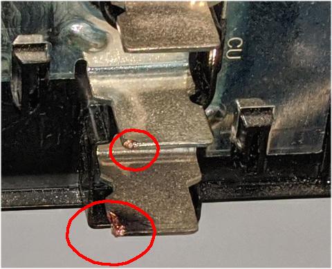

Here you can see the lowest part of the bus where there is a metal burnt mark.
Yes I know the wires were all messy and should be neatly tucked away, but they were this way because I untangled them to replace them.
It was scary as it was pretty loud and some sparks.
So now the lower two fins of the bus, they are now damaged? Is it damaged serious enough to cause problems if I ever add more breakers to connect to them? I assume you can't replace a section of the bus you must replace the whole thing?

I do not anticipate to ever need to expand all the way to use up all 40 slots, but never say never. I am on slot 25 now and I have a few unused one above that I have disconnected due to switch some appliances to gas.
But in the event I do need that slot, what would be the remedy? Replace the entire bus? Replace the panel? Or leave that and switch a few slots to use the skinny tandem breakers?

Messy wires are not bad. What is bad is when your wires are too short to give you freedom to move breakers around,
Those ground wires have lost cross-section and thus are not safe. It looks like those wires are taking the scenic route though, so add a $6 accessory ground bar to this panel, and terminate them there.
Those ground wires were all in the process of getting replaced. That's why they were all untangled. They are no more.
If you are hellbound and determined to get it back, then A) get accessory ground bars for this panel and move all grounds to them. B) have your electrician change your meter pan to a meter-main, so you can do this next part safely, because handling unfused service wires live is out of the question.
I can get this entire panel de-energized including the feeder wires because this is a sub-panel. The main panel is on the other side of this wall, and the feeder wires are connected to the main lugs of the main panel. I can turn the whole house breakers off in the main panel to completely de-energize this panel.
I guess I am going to hold off since I still have 16 empty slots left in this panel and 3 in the main panel.
But now I am thinking may be my stupid accident actually might have caused more damages that meets the eyes. I will describe it in my next post.
