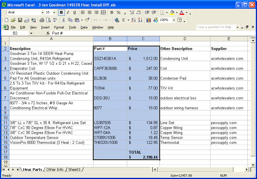

Hi,
I live in Portland OR and I'm about to pull the trigger on the order and add a 3 ton Heat Pump to my existing Trane XV90 80,000 BTU furnace. I'm an Electrical Engineer for my day job and I love DIY projects.
I was looking at Goodman, Rheem, Rudd, and Trane. Since I can get such a good deal on Goodman, and I've only heard good things about them, I'm going that route. Sounds like Goodman makes stuff that goes into new houses and they are more value oriented, but with such a good warranty seems like I can't go wrong. Plus it seems like Goodman is more availble to the DIY'er. I've decided to go with the 14 SEER unit, the SSZ140361A. This is only a few hundred more then the 13 SEER unit and seems like they put the higher quality compressor, and they offer the lifetime warranty on it, etc. Also since I'll be heating with it, seems like the extra money is worth it..
Here is the parts list I've come up with to this point. I'm going to get my stuff from www.acwholesalers.com and www.pexsupply.com. I'll also need wiring and other various items, but I plan on Home Depot for those..
Since tables don't seem to work very well I'll put a link here to my working spreadsheet:
http://www.skylab.org/~chugga/forums/3-ton%20Goodman%2014SEER%20Hvac%20Install%20DIY.xls
And a screenshot:

You mismatch like that, and you'll be ripping that coil back out.
There is no 3636 coil match for that outdoor unit.
That coil is too small.

Listen to Beenthere. I just went to Goodman Partner Link and downloaded all the possible matches for the SSZ140361A and at best, you can probably get away with a CAPF4860. You might have to do some transition to your furnace. The actual only match is a CAPF4961 + a TXV. Good luck finding that coil.
Unless Goodman has made match changes, you would be wise to really look at the sizing before you order.
I am not speaking from the position of a pro who is seeing you buy your own equipment, but from the standpoint of another HVAC Online Retailer who can tell you that for both parties involved, this stuff does not return well. Make sure before your pull your trigger. ACWholesalers have that information and should be able to provide you with it.

Thanks for the comments. Helps if you do your homework right? Yaa, looks like that coil isn't in the table for the 14SEER unit, can't just use the 13 SEER recommended coil and expect it to scale..

So, looking at the datasheets, the 3636 Coil that I really want to use will work with the 3 ton SEER13 R22 unit or the 2.5 ton SEER14 R410A unit. Is it possible to get another coil other then the Goodman coil that will fit in my cramped space? (less then 24 inches high) The wider coils don't seem to buy me much, just the taller 30" ones. I'm temped to go down to the 2.5 ton unit, it will just run more often. I'm planning on insolating my floors and attics in the near future anyway.. My house is only 1900 square feet.
It's a bummer my furnace is only a few years old or I'd get a smaller wider air handler with venting out the side...
If I did go with the 2.5 ton unit, should I run 7/8 line (per the coil) or the 3/4 (per the condenser). I'm going about 30 ft. Sounds like they suggest using a reducer and running 3/4 but do you gain anything by running bigger line, or does it throw off the system having more coolant in the lines then expected?

Now obviously I want to choose a coil pair that's designed to work with the condenser.
Jeff,
All that Honeywell noise that you have going on above your furnace, is there anyway you could utilize that space for your required added coil height, and then place those accessories elsewhere in the system? Just a thought.
Also, you have those two transitions happening above and below the filters. Looks from the pic, like you could also use that space to gain the needed height that a 4/5 ton coil will add. Just thinkin out loud.
