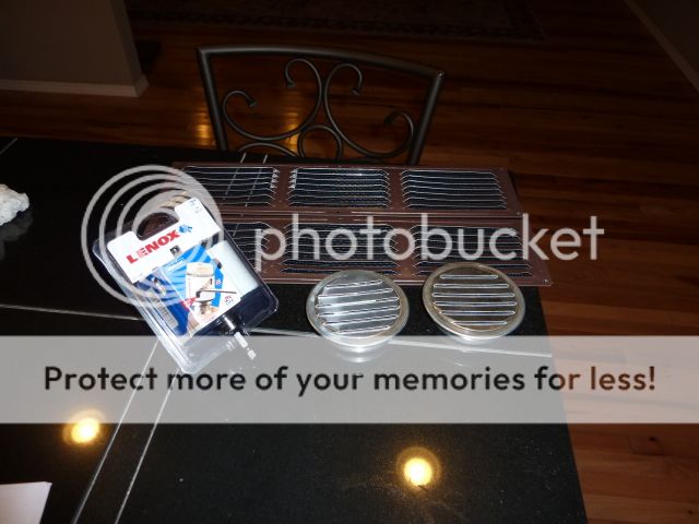

doing the math on ridge to soffit venting. earlier today i found these at lowes, claim a maximum 27sq/in for flow {brown grates} along with basic 3" hole vents
the problem i have is that i forgot how to figure sq/in. i plan on using a 3" hole saw to put holes in the soffits then silicone these screens over say...4 of them.
a 3" circle has a 1.5" radius and a 9.424 circumference along with a total area of 7.068 but i totally forgot how to transform this into sq/in to get an idea of how much i'll need to get that ridge vent working efficiently
also worth noting he humidity is down to 40% ish and holding
Do you mean convert to SQ FT? Divide by 144. Each 3" rd hole will give you 7/144=.05 sq ft. Gonna be doing a lot of drilling.

well, i already have a good chunk of soffit venting, just need to add more. from what i gather i need to be at 1:1 intake/exhaust and being 2:1 favoring the soffit isn't a bad idea when possible
just realized area is sq/in since it's the total area of the circle. my ridge vent flows 32sq/in every 2 feet which would mean 5 of those 3" holes would be 35 sq/in

If the soffit vents are substantially more than the exhaust vents, the air could move from one soffit vent to another close by rather than to the ridge vent. This is why there are limits on the percentage system. The soffit air feeds the ridge vent. The new “I” codes reflect this by limiting soffit at 50-60% maximum, more than exhaust: http://publicecodes.citation.com/ico...006_par001.htm
Regardless, you are under your own State Energy Code of balanced system with ½ intake, ½ exhaust to use the 1/300 rule. If adding more soffit venting percentage past 50%, be sure to meet the 1/300 rule first. “Ventilation in attics
“The attic ventilation requirement is one square foot of net
free vent area per 150 square feet of ceiling. This is often
abbreviated as 1/150. If half the vents are placed low, at the
eaves, and half the vents are placed high, at the ridge or
gable end, the vent to ceiling ratio may be reduced to 1/300.” “Flat ceiling insulation” – just above Fig. 1: http://www.cbs.state.or.us/external/...ResPub_all.pdf
To clarify: meet your 50/50 rule for 1/300 first; then add additional soffit venting to get your greater soffit percentage.
10-15 % (or 55-58%) more soffit than exhaust is recommended here, pp. 615: http://books.google.com/books?id=Z8a...0vents&f=false
2:1 is here: http://www.inspectapedia.com/interiors/atticcond10.htm
BSC recommends 60/40 best: http://www.buildingscience.com/docum...n-roof-venting
From the picture, it appears your ridge vent doesn’t have baffles, which are much better by giving you negative pressure (suction): http://oikos.com/esb/30/atticvent.html
http://www.buildsite.com/dbderived/a...rived20936.pdf
The circular vent Net Free Ventilation Area (NFVA) is minus the screening and louvers: (1.735 NFVA) https://ventmastersstore.com/shop/3-...ack-p-128.html
May need to re-figure your NFVA: http://www.airvent.com/homeowner/pro...it-specs.shtml

i don't have the cool baffled ridge vent but boy do i ever relate to
The ratio of soffit intake to roof outlet should be at least 2:1 to avoid unnecessary these heat losses from the building. A serious error is a roof outlet vent net free area that exceeds the air inlets at lower roof edges or eaves. When this occurs in a climate where building heating is needed during part of the year, warm air leaking into the attic or roof space and exiting at the ridge vent (or other vents high on the roof) creates a convection air current that draws excessive heat out of the building during the heating season, leading to unnecessarily high heating costs.
as it sits now i have somewhere close to .6sq/in of intake for every 1 sq/in of exhaust. your links and others have made me realize what seems so obvious now, the ridge IS venting and is pulling air from the easiest source. it's why the gable end turned into an intake when it was open and why i need to seal my attic deck and add more intake. i added about 50sq/in of intake today and will continue to do so until i get to at least 1.1sq/in of intake for every 1sq/in of exhaust. i'm not sure i can achieve 2:1 but i think 1.5-1 could be in the cards
thanks again for the links i will read through them all
oh, for my IC rated can lights, is spray foaming around the loose edge between it and the sheetrock okay or does each canister require a box or foam baffle to be placed over it?
