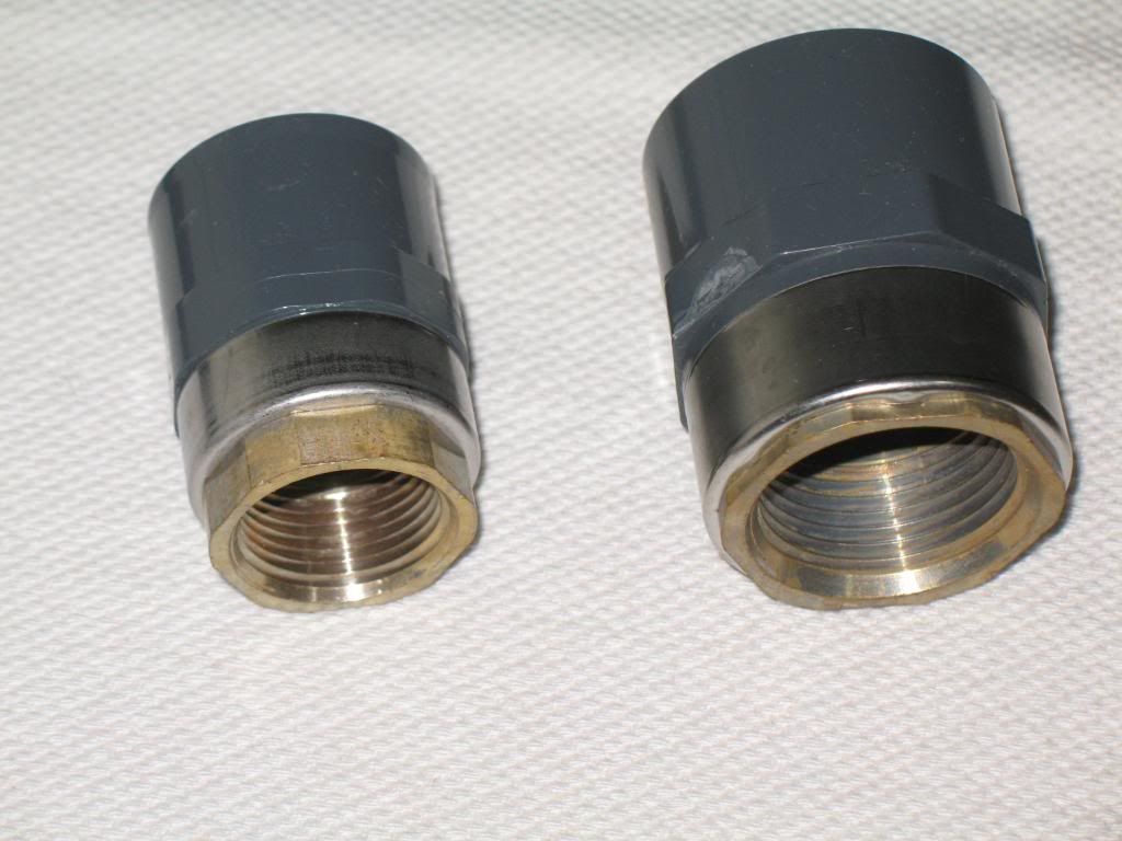

Thanks for the tip man. I'm going to the local plumbing store tomorrow morning. Do you have a brand of pressure regulator that you like. It will go on a 1" copper line. Check out the fittings below that picked up from a industrial piping supplier yesterday. Do you think this would work at my meter for a metal to PVC transition. These are brass and PVC some how bonded together. I got a 1" and 3/4" NPT style.
PVC Side
Brass Side
vcheez is offline   Reply With Quote
PVC Side
Brass Side
Try to get a PRV that has a removable screen inside, nice if you have some dirt in the main and need to give it a clean
