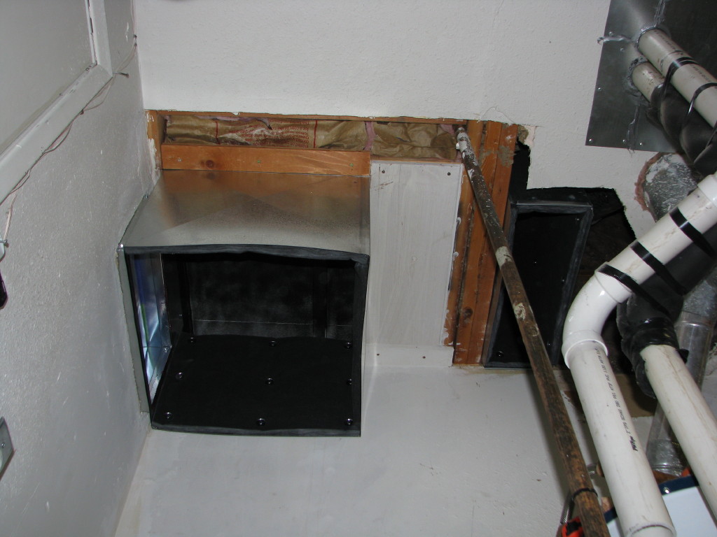

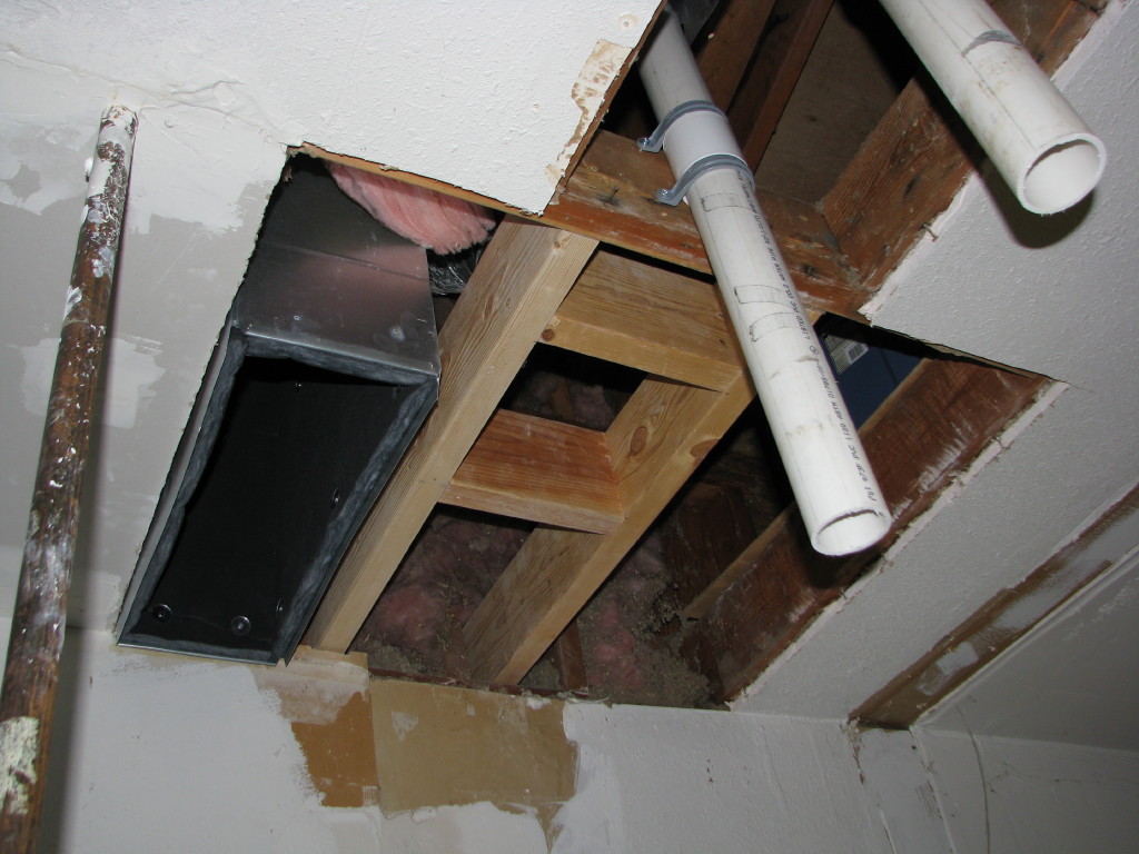

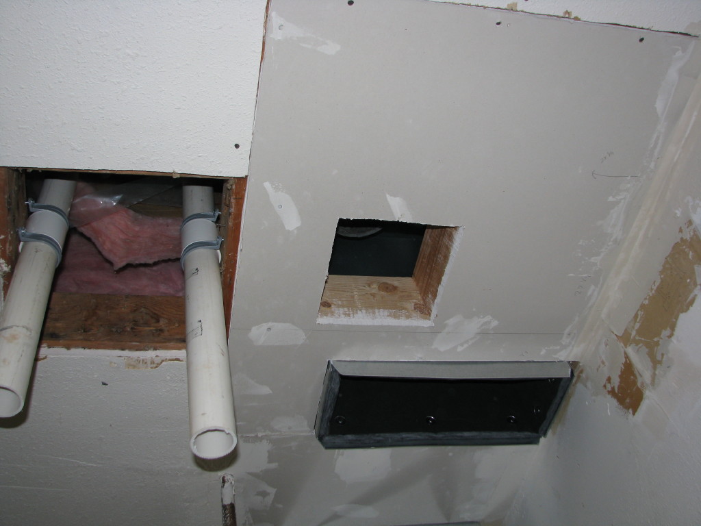

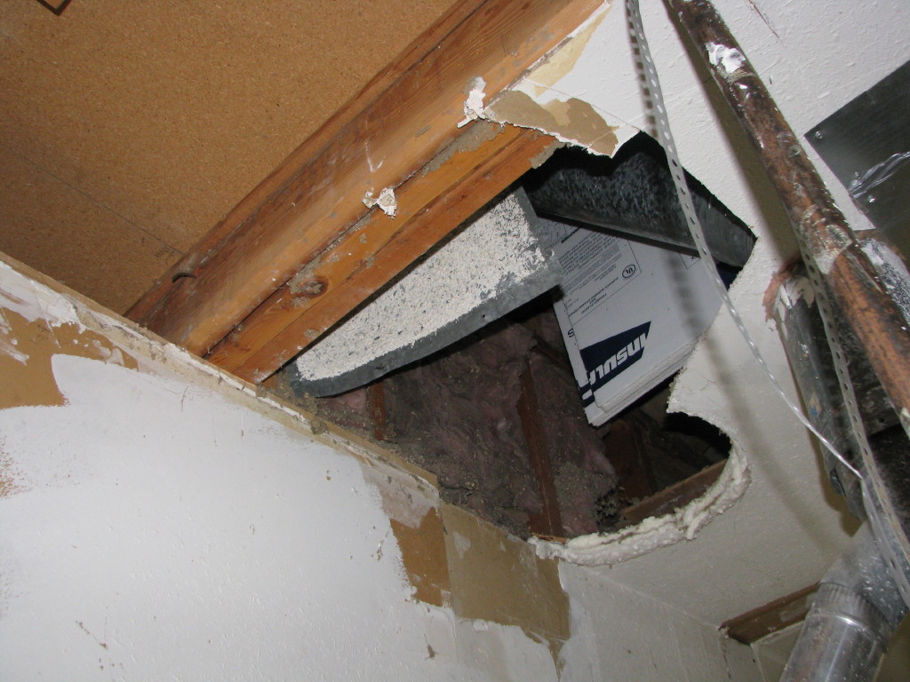

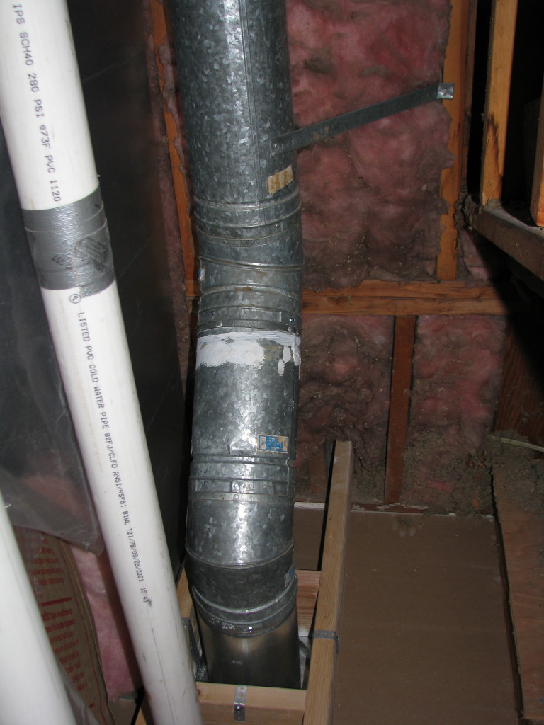

Here is what I wound up doing:
I had this crappy flu that was rusting out, the Y was cracking at the seam:
Never really got a good picture, but here you can see the Bvent right up against the drywall as it comes into the garage from the attic. This was violating the 1" to combustibles. The vent in the attic was mostly good 6" b-vent but there was a single-wall 6" section 24" long that connects between two b-vent 45's that a "pro" let get by and the inspector didn't do a thing about. This single wall was also right against paper insulation backing.
Another view
Made a nice little box to support the firestop and drywall:
Added drywall:
Connected the old B-Vent to the new Simpson Duravent that I got from my local Johnson Air Supply, with temporary flex vent to tide me over..
All finished with transitions and b-vent
And another shot
All the venting in the attic and almost all the way to the water heater is now b-vent. I also made sure I have 1" to everything around the b-vent.
I miss-calculated how much bvent I needed so I still have the single wall for the last 6" section. I currently have 3" transition -> 45 > 45 -> Draft Hood -> singlewall 90
I might get another b-vent 90 or take back a 45 and get a 6" section and a 90... For now this is working though..
