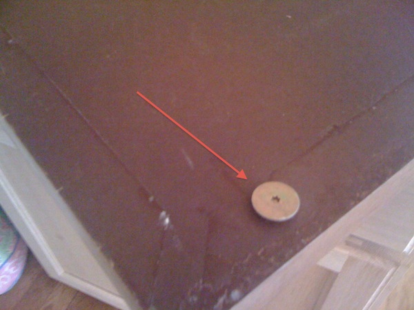

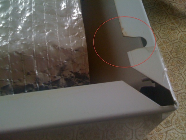

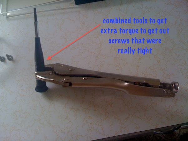

Since this was really the only informative post I found online on this topic I wanted to post some photos of my conversion of my portable dishwasher to an under counter dishwasher which will hopefully help people get a better visual.
Prior to this I had never installed even a regular dishwasher or done any plumbing so the list, although it looked manageable, looked a bit greek to me.
I was converting a Maytag MDC4000AWX portable dishwasher.
Let's start with removing the counter. I removed all of the screws from the housing. I had to combine tools in order to get enough torque to get off a few:
Initially thought the counter would just lift off. Turned out that it slid forward to come off because of these:
And on the dishwasher, they slid out from these types of slots:
