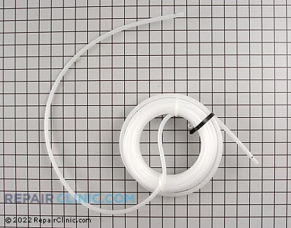

If you still want to do it via your proposal, then maybe consider placing the on/off valve in the water line "before" it enters your mini-fridge. This way the tank in the fridge will not be pressurized. You could just use coiled up pex tubing in the fridge to hold the water which is how many refrigerators do it. Just have the outlet tubing higher than the water reservoir to prevent siphoning. Or you could buy a replacement plastic reservoir for a refrigerator and put that in your mini-fridge.
This set up would work the same as the cold water dispenser in all refrigerators except that you would use a manual on/off valve instead of an electric solenoid. Or you could get fancy and install an electric solenoid from a refrigerator and press a button to dispense the water.
EDIT: Or you could run a pex line into your current refrigerator, coil the pex line up inside to act as a reservoir and exit your refrigerator at a convenient point. Find a plastic box, like a shoe box, at a store and put the coiled up pex line in it to isolate the line from your normal food items. A refrigerator water dispenser solenoid and a push button would be much cheaper than buying a mini-fridge and there wouldn't be additional, ongoing expenses for electricity for a mini-fridge.

Hmm so coiling would be acceptable? That is the easiest route. I don't even need any fittings inside the fridge, both ends can come out. Would I want to add a check valve before it enters the kitchen?

Yup, coiled tubing is how some refrigerators provide a reservoir for their cold water dispenser. Here's an example of a coil type reservoir that sells for $13.20:
http://www.rcappliancepartsimages.co...0/00890471.jpg
And a link to the item:
http://www.repairclinic.com/PartDeta...ntainer/962383
Refrigerators don't have a check valve in their water dispensers. They just have the tubing from the dispenser solenoid run to the reservoir (tank or coiled tubing) in the food side. The output tubing is run to the door on the freezer and ends up at the water dispenser spout. The tubing in the freezer door is not cooled so that does cause the first few seconds of water to be warm until the cold water from the reservoir exits the dispenser spout.
