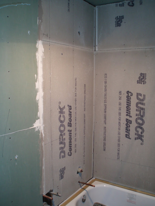

In progress:
one sheet of drywall is backwards
My first tile job

Hate to ask but is the cement board over the lip of the tub? Its hard to tell from the pics. The plastic behind the board ( if you put any) should end past the lip and the board goes up to the lip. I'll find a pic.....

Here is a pic to show what im talking about.....
