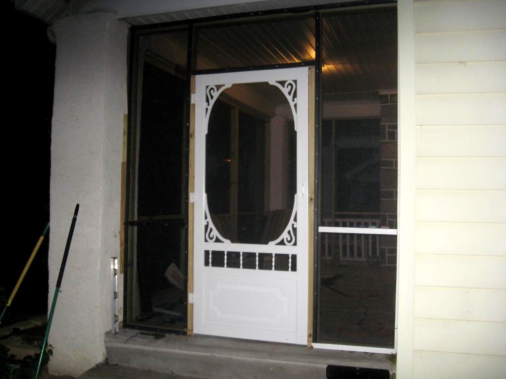

Enclosing Porch
thanks for the tip on the eye hook....that worked perfectly.
tomorrow i will get the top plate up and add studs to the front section.
i still have to get a door. i am leaning towards a pressure treated door, as opposed to vinyl. is there a reason to go for vinyl?
regarding water, even unscreened we don't get much on the porch. a few neighbors have screened porches and I haven't seen any space left for drainage. I understand the concern but based on how the dry the porch tends to stay normally, I think I will be ok.
although this is my largest DIY job to this point, I am confident/hopeful that even those who seem to be against screening (a lot of neighbors have enclosed their porches completely with vinyl siding/drwall and I think that takes away from the curch appeal) will see that I am not going to do a half as@ job. I am really determined to take my time and do this right. we really don't use this space as is and i guess if we alter the appearance slightly, gaining access to some more "living space" is worth it. this, i guess, is more of a philosophical/aesthetic difference than anything. i respect that. thanks so much for all of your feedback, and I will keep you guys updated

Enclosing Porch
an update-
i removed the knee wall i built. i was having a really tough time stick framing. made an attempt at framing a 5' section of the wall on the ground and lifting it in place. this was much easier. i know framing on the ground is easier, but i avoided doing it this way since the porch is somewhat uneven. one mistake i made was building the wall in my driveway and then attempting to move it to the porch, which was obviously a mistake. if i am going to continue framing on the ground i am going to have to do it on the porch which doesn;t give me a lot of room to work.
feel like i am getting the hang of this. updated pic.

Enclosing Porch
Awfully big gaps around the screen door. You need to install stops to close up the gaps and give something for the door to close against.

Posts: 433
Enclosing Porch
thanks for taking a look.
i know. i removed the stops to install the door latch. how does everything else look?

Enclosing Porch
I was one on the early on posters who had concerns about changing the look of your house. What I said was:
"IMO you have a beautiful, inviting front entrance area. I think enclosing it without a very serious thought on the style of the architecture will make it look like a wart on a toad's butt. I personally would not change it but if you do, I would consult an architect."
I would like to see a picture from the curb so I can see an overall picture of your project. The work that you have done looks fine but I would have liked to see use of more traditional materials which reflect the period of your home.
Just me maybe but I hate to see vinyl on old houses. Screen tight is an easy product to use but I do not think it adds to the historic look. I would add pickets to the lower section of the screening. It will be a more period look and will add protection from kids and pets.
