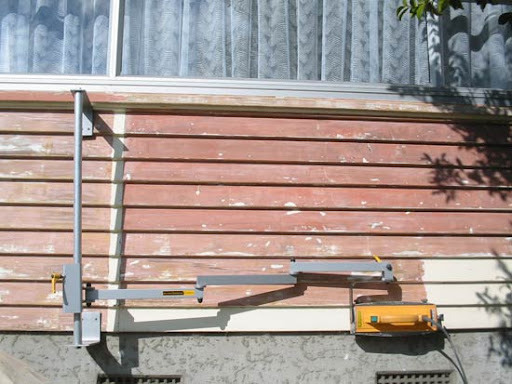

I've used power shavers, then power scrapers, then power sanders and such on antique siding but it is lots of work and it sends everything airborne. And your arms and upper body will get a workout. You may rattle dental work loose with a power shaver though.
I will mention a magical alternative again. An infrared stripper is an amazing tool. Lightweight, fast, safe, neat.
You can rent them but waiting lists will soon be forming as others start in on home exteriors. If you have the cashflow, I would buy one, use for as long as needed and then turn around and sell it. You will not have any trouble getting rid of it and buying and selling it may be cheaper than renting one? At least you will be under no pressure to return it.
I used mine inside and out extensively and it provided one of the best approaches to stripping paint and varnish I ever encountered. Do get one of the rail systems so you can just glide it along hands free for exterior siding. Be warned, a full set up will set you back $400-500 new still I think. I had no trouble justifying the cost of mine.
Of course you still need a SHARP hand scraper or two to go with it. You still have to address lead abatement issues and will want to wear protective clothing and masks. You still have to sand and prep the surface for painting. But getting rid of finish is a snap with one of these. Note the pic of the guy taking off layers of marine finish!
