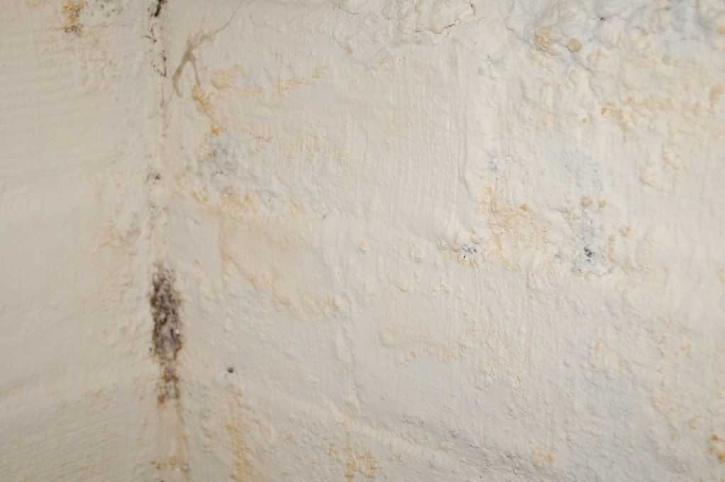

I have a 1922 house with the same terracotta block foundation. Almost all of basement walls have been painted at one time or another. Some of the walls have little moisture problems but the north wall has lots of moisture coming through and all the paint is spalling/flaking off. This is in our laundry room. I would like to make the space look better and clean up the walls.
I think I can correct some of moisture issues by filling some low spots in my driveway where water is leaking in around the foundation. What can I do with this brick wall to improve it appearance? Not a good idea to put any kind of coating/sealer on the wall?

Many of my walls are painted and have been for a long time and are holding paint well. The problem is when you have moisture or water coming thru. My one wall will not hold anthing. Here are some pictures.
A light glance with a scaper and many layers of this paint literaly flake off to reveal the red clay.

Wow, definitely some water issues there! Gutters clogged? No foundation drainage? Definitely an issue OUTSIDE the wall.

Low spots in cracked asphalt drive. The only side of my house with water problems is the entire side that is lined with a 9' driveway. Water pools in an area and then seeps in I suspect. Or else water is moving lateraly from beyond the drive and then seeps in.
