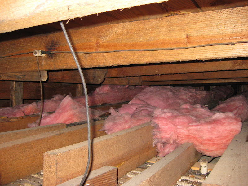

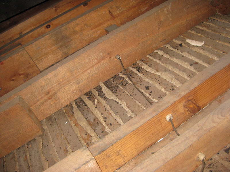

I was able to poke my head up in the current access and take some pics, heres a pic from above where I plan to put in the access.
Besides the wire you see in the previous pic there is also, what looks like copper wire that runs from the ceiling joist to the roof rafters in various places...any ideas what this is and why it is there?
the attic access would be just to the left of what you see in the previous pic.

That looks exactly like some of the older homes down here in my area. Those are "tube and knob" wiring apparatus, and I hope they are not still in use. IF you decide to remove those old insulators, save them, they are valuable around here for sure. The larger copper wires I've seen in older homes around here that had---Lightning Rods on top of the homes years ago. IF by chance you still have the Lightning Rods still on the house, do save them, especially if they have the old glass balls. They are very expensive in antique shops around here, and everywhere I have seen. As far as your new access, you can make it any size you wish, as long as you do adequate framing. You stated "Our last house", so I figure there is the "lady of the house" involved with what is stored up there. Just don't let her get carried away as my wife did. There must be two tons of "important things", can you say-junk, up in our attic. Good Luck, David

Would it be safe to say the tube and knob system is not in use since I have a modern breaker box, fixtures, switches and outlets?

Regardless if you have a new breaker box, outlets, switches, fixtures. K&T can still carry power if not disconnected if new wiring was not installed at the time.

In homses where K&T was previously installed I frequently find energized sections of K&T on branch circuits running back to updated service equipment - around one property in three.

If you are going to be working around up there insulating and installing decking, you want to be careful around that old knob and tube. The theory behind it was OK, but the materials were not up to todays standards. You'll find the insulation to be very brittle. If you've had critters in the attic, make sure you check it out thoroughly. I've seen the insulation chewed off of this stuff. I even found a skeleton of a critter next to two chewed wires. Guess he got across the hot and neutral conductors after he had them bare. They could have been that way for 30-40 years. You don't want to become the critter across two bare wires while you insulate. Best bet is to eliminate the stuff before you insulate and floor the space for storage.

Will do, I plan on double checking to make sure it's not live then removing it. Who knows maybe I can make a few $$ on the copper and ceramic pieces.

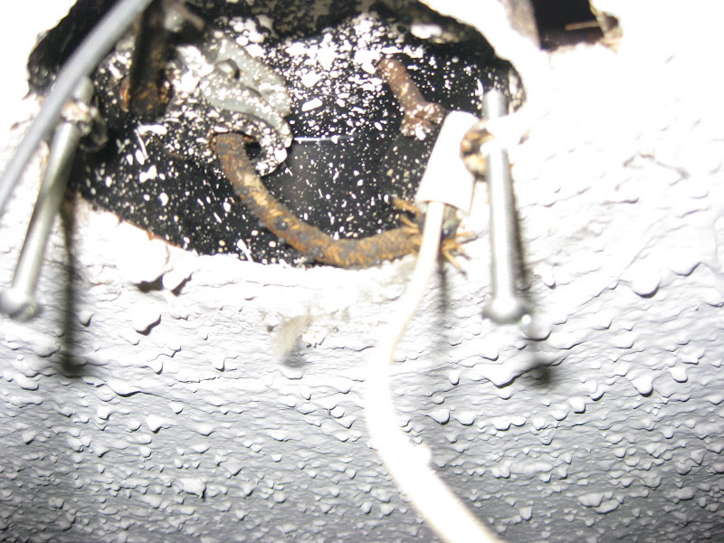

I'm thinking about undertaking this project today. I am worried about doing it if when I get the ceiling out then I realize that its a knob and tube system up there. Below is a picture of the wires feeding the light in the hallway. Its not a great pic but shows two wires coming into the box insulated with like a braided material...they are tied to the leeds for the light.
Is it possible to confirm or deny that this fixture is fed by the tube and knob system? I will try to get up in that access hole and use my tester on the K&T system
cbaileyau is offline   Reply With Quote

Well, I got up there (through the small hole in the closet) and all the K&T wires i could get to were hot. So....I can't really upgrade the system until I have access up there, but I can't open it up in the hall cause of the K&T wires running overhead. Does anyone have any resources on how to "patch" one of these systems so I can at least, temporarily rewire the hall light and remove that portion of the K&T in order to create an access to get to the rest.
Do I need to remove the K&T in the first place? I have read that the system works fine if it is in good condition...but being 80 years old...its hard to believe that is the case.

I am pretty sure you cannot bury knob and tube in insulation if it is being used. I would shut down breakers until you lose power on the wire in the way. Maybe you can just do with out that circuit for a while. Then make it the first circuit you rewire. I would rewire first and then insulate.
