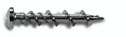

there is a new product out called a Wall Dawg, and they work great. it basically just a real course screw but they really hold nice. no predrilling needed, just put fixture up and insert screw through hole and turn into drywall, like you wood a draywall screw. a friend turned me on to them a couple years ago and i use them all the time, very happy so far

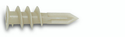

there is also a product called a zip it, or easy anchor,k that comes in plastic or metal. you use a phillips head screw driver, ind screw these in first, then screw the screw into the anchor that's in the drywall. these also work very well, and can easily removed, and if you ever decide to remove what you hung up, you simply turn the anchor out with a screwdriver OR better yet, turn the anchor in a little deeper, so it sits below the surface, and just spackle right over top of the anchor, much easier

Wall Dawg
Zip-it or EZ Anchor

Zip-it or EZ Anchor
I have used both, and while certainly a big improvement over a plastic anchor, they also eventually pull out of the wall.
