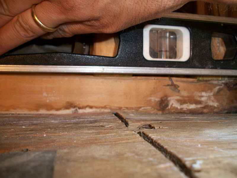

mjzraz 06-12-2010 06:27 PM
Here's our damage
http://lh3.ggpht.com/_b9K9YGlmNT8/TA...0/100_1742.JPG
Inside you cna see where the door sill dips down:
http://lh3.ggpht.com/_b9K9YGlmNT8/TA...0/100_1728.JPG
The Floor plate is 1/4 " lower at the jack stud:
http://lh3.ggpht.com/_b9K9YGlmNT8/TA...0/100_1732.JPG
http://lh6.ggpht.com/_b9K9YGlmNT8/TA...0/100_1739.JPG
Plywood damage doesn't go too far under the wall plate, but it's odd (to me) that it wasn't flush with the rim joist and wall plate:
http://lh5.ggpht.com/_b9K9YGlmNT8/TA...0/100_1743.JPG
http://lh6.ggpht.com/_b9K9YGlmNT8/TA...0/100_1744.JPG
kwerk 08-13-2010 11:43 AM
Originally Posted by mjzraz (Post 455273)
Here's our damage
I have the exact same problem, my subfloor is also not flush with the rim joist or wall plate. The wall plate hangs over the subfloor about 1".
