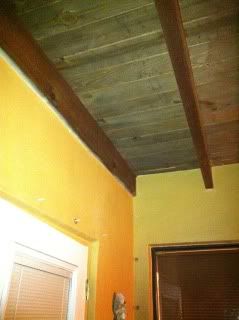

Ok I am doing a demo on my existing flat porch roof that is part of my house so I can have a pool installed,
the other half of the flat roof sits over my living room in the back of my house its not being removed, all the exposed beams in the patio for the roof (demo side) are supported at the house by the tiebeam and opposite by a support beam that is held up by a metal bracket at the house on one end and two metal columns away from the house,
after removing the flat roof I need to hang one of the beams to keep a soffit of 16" away from the wall that will be in parallel with this beam, at one end the house supports this beam (2x8),
at the other I have nothing, was wondering if there were brackets that could be red headed to the tiebeam to hang this beam from, its about 12 feet in length but is only holding up the soffet/fascia portion of this part of the roof, I don't want to use a column.

Old 02-01-2012, 11:17 PM   #7
Join Date: Jan 2012
Location: Cooper City, Florida
Posts: 8
Ideas for hanging a beam
Heres the pics you want
The beam on the wall is tied into another wood beam that sits on top of the tiebeam (just realized) on the wall that is going to need a soffit, no access from the attic b/c its a flat roof.
Here is where it exits off the bldg and is also resting on a 4x12, at the wall under the 4x12 is a steel L bracket that the 4x12 sits on for support.
If I don't need to do a eave/fascia soffit overhang than fine if the code is ok with it (is it required) rain is still gonna get on the doors regardless, and if I put a 4-6 inch overhang I am still gonna put a gutter system along it, aesthically it would be nice to have a overhang matching the house, but I could do with out.

I thought I knew what you were talking about until I saw the pictures. Now I don't know what you are talking about. Where is the soffit, and which is the beam parallel to the one you want to add?
abracaboom is offline   Reply With Quote
Old 02-04-2012, 08:48 PM   #11
Join Date: Jan 2012
Posts: 8
The wood ceiling and beams you see in pic will all be removed except the one along the wall above the doors this is where I need to either make an overhang parallel to that wall to put fascia and soffit or just leave it a 4-6" in overhang along that Wall and not worry about creating a wide overhang, if you follow.
So the yellow beam is staying, and the dark brown joists are going away along with the roof deck.
Put in new dark brown joists that overhang the yellow beam as much as you want, and let your new parallel beam be supported by the new overhanging dark brown joists.
