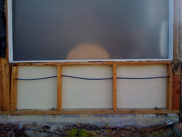

Have an issue with termite damage, I am repairing the damage, and installing a new window. Pella Thermstar 6x5 slider.
Currently the siding was plywood, but will be stucco.
House was built in 1986 area is San Diego, CA.
Question(s) regarding sheathing/flashing.
Originally just paper/taped very few places.
Should I cover with wood?
Should I use paper or plastic house wrap, tape, or peel & stick?
If it's recommended to use wood sheathing can I use 7/16 OSB, or should I stick with 11/32 plywood like it had on there?
I'd much rather use paper since I'm not sold on plastic housewrap seeing what UV does to the stuff.
Not to mention the cost difference.
Here's a pic of what I'm dealing with...

No more daylight but it looks like this now...
Not as much as I wanted to get done, but such is life...
New hangar on header, rough opening enlarged from 71.5"x59" > 72.25"x60"
No more termite chewed to hell wood...YAY!

Flashing/sheathing for new const. window in siding that will be redone in stucco
Header is not to code, cripple studs not spaced at 16" O.C. the hanger for the header may or may not be right.
Permits?
Andy.
Permits?
Andy.
Header is unchanged from original.
Cripple studs replaced per what was there originally as well.
Hanger was added because there wasn't one there, just a flat plate tied/nailed to 2x4 stud I had to replace.
Pic(s) of the wall before I removed/replaced stud/sill/hanger/cripple studs.
Several issues with the wall when the house was built.
Wood that wasn't even nailed together just hang in' around.
Wall always seemed "loose" to me, but when I'm done @ least everything will be nailed together.
Permit will be pulled next week. Was going to get one last week, but the 11/mo. old baby was not cooperating.
You are dong a significant repair/change to the wall, they will want it brought up to code so the header is under-sized, prescriptive code calls for the header to be bearing on a trimmer, cripples aren't that big a deal but they may want to see them on 16"s.
Permit for electrical required, plan of the framing showing cross section of wall with header, stucco, paper, insulation, etc.
CF-1R for the new window, prescriptive only no computer generated output, MF-1R attached to the plans.
I am just letting you know what you could expect from the Building Department. I do this for a living here in California so I am pretty confidant that they will ask for all this and more.
